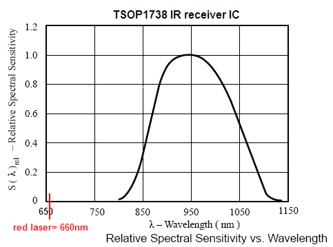

You are talking about using a laser which is not IR and which probably won't be received very well by an IR receiver IC.

The case of a TSOP1738 IR receiver IC is black and blocks visible light very well. I know a red laser is very bright but look at this graph and try to determine how little of the red light will be detected.
