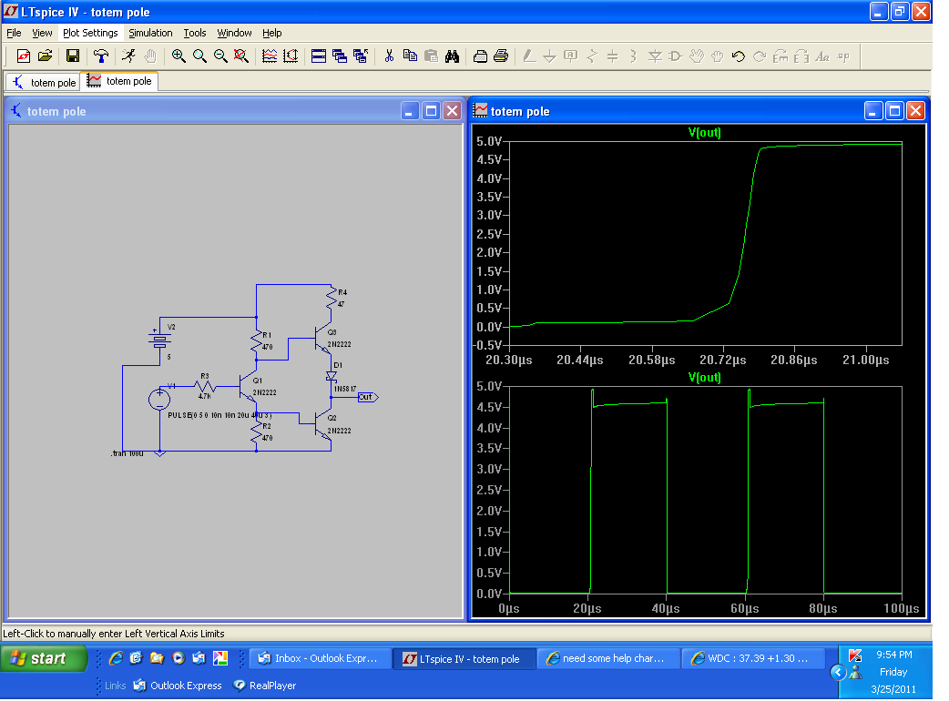

hi, i'm finishing my fan controller and i'm having problems controling the current to the fans.

So I need to control 24A (8x 3A 12V fans), switching on and of the 12V that goes to the fans.
The pwm signal works at 25Khz, , that's 40µs each cycle, so it has to, at most, charge the gate in less than 0.4µs (for 2% to 98% cycle duty precision)
I have this circuit in the simulator but the ocsiloscope still shows some noise in the 12 volt signal.
(with just one pair of TIP104, 105, i still have the same problem)
Is there any better way to do this? Because even with all the amplification I still cant charge it fast enough as to have a straigt edge instead of a curve in the gate voltage.
You have three sets of emitter followers (5Vbe drops) between the 5V control signal and the gate of the fet, so the gate signal can only be pulled to 5-5*(0.65) = 5-3.25 = 1.75V which will never turn on the Fet. Use only one inverting push-pull driver, or go buy and IC specifically made for this job; one that will drive the gates with a full 5V swing.

Totem Pole
Maybe something like this. Little old fashon but fairly fast.

@mike
yes it's logic level, (with 12Vds, 4A at 3Vgs, 20A at 4Vgs, and 70A (out of specs) at 6Vgs, so at 5Vgs i suppose it can do 50A)

@ron
ill take a look at it, seems good enough, thanks.
@thunderchild
the problem is that the voltage line from the osciloscope doesn't go up straight away, but with a little curve, so if i set the pwm at less than ~10% cycle duty, it starts to interfere, same at ~90%.
(ill post a screenshot in just a minute)

lower one is input, upper one is Vgs
