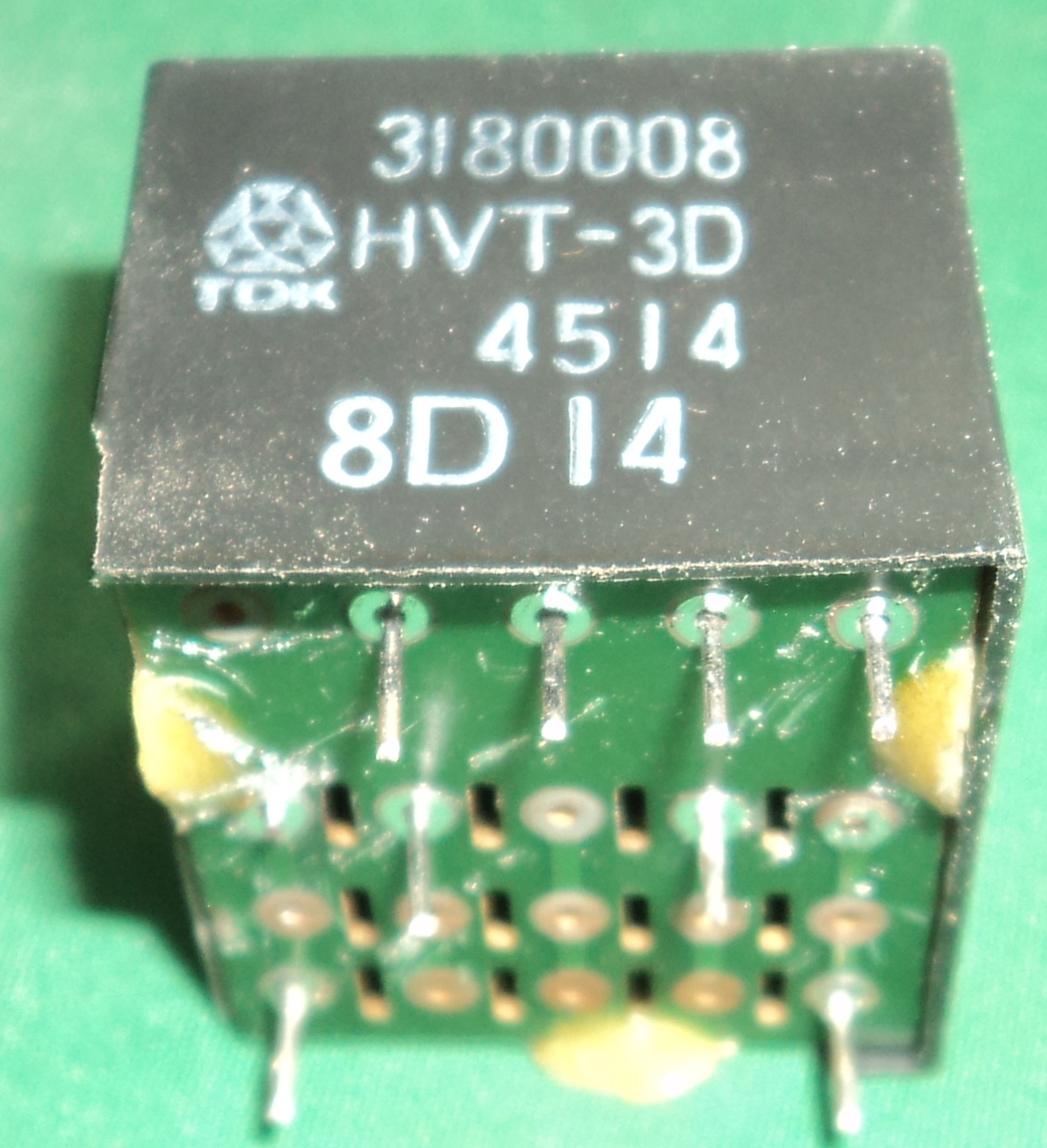

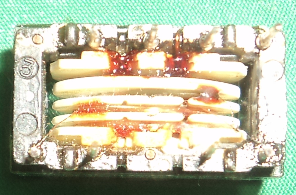

Needing transformer for goldstar oscilloscope
Heres the photos!
I honestly cant beleive i did not give up!, the fairrite core broke when putting apart as i heated it a little, and it seemed to weaken it, although it came out easily, it crumbled quite easy, and then having to guess the windings etc, i even think the wire was a slightly bigger diameter, but who cares, its IT WORKS!
yes Congrats... But not for long
I turned it on a few hours ago, and no scan line on the screen.
I opened it, and i think the driver transistor for the transformer may be causing problems, i havnt tested the newly wound transformer to see if it has burnt out, but i noticed that the driver transistor's instuator had got a little melted, and i think the collector may have earthed through to the heatsink and chassis, after testing with a multimeter, it had a low resistance to the earth, so i think this may have been the cause for the transformer to blow up in the first place, although the transistor tests ok, i think i will replace both the transistor, and if i have to, replace the transformer. Anyway, ill keep ypu posted :)

estas son las fotos, de GOSs-620 , oscilloscpe, saludos desde Perú

Yes that looks like the transormer!
Unfortunatley with my scope was that it actually had an intermittent internal filament short in the CRT i discovered, which caused the transformer to burn out in the first place. I ended up throwing it out, but was a good learning experience anyway with regard to winding these transformers.
