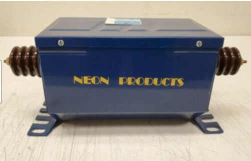

That is exactly it, yes. Depending on the size of your coil, shoot for 8+kV. Larger coils will probably require a higher voltage. 10mA would be the absolute minimum, but I'd shoot for at least 20 if at all possible.Would something like this work?
If these are around the same voltage and amprage as a NST, why are they so much cheaper? I understand there will probably be a slight downscale in performance with the Oil burners, but what if I had four in phase? My tesla coil is around 3 feet (secondary pvc only) if these will work I will be forever thankful!That is exactly it, yes. Depending on the size of your coil, shoot for 8+kV. Larger coils will probably require a higher voltage. 10mA would be the absolute minimum, but I'd shoot for at least 20 if at all possible.
Like the NSTs, make sure the OBIT you get is the bulky cube-shaped type and is not labeled "Solid-State". SS transformers operate at too high a frequency and will not charge the capacitor fully between cycles, leading to very poor efficiency and, most likely, a non-working coil. The one in the picture looks good, though I can't make out the label. Output frequency should be either 50 or 60 Hz.
There is no downgrade to performance in my experience. They're most likely cheaper because they're more plentiful. You'll have the occasional shop which has a neon sign, but a large number of homes within the same area will have these on oil burners (definitely more prevalent up north though as home heating becomes more of a chore).If these are around the same voltage and amprage as a NST, why are they so much cheaper? I understand there will probably be a slight downscale in performance with the Oil burners, but what if I had four in phase? My tesla coil is around 3 feet (secondary pvc only) if these will work I will be forever thankful!
