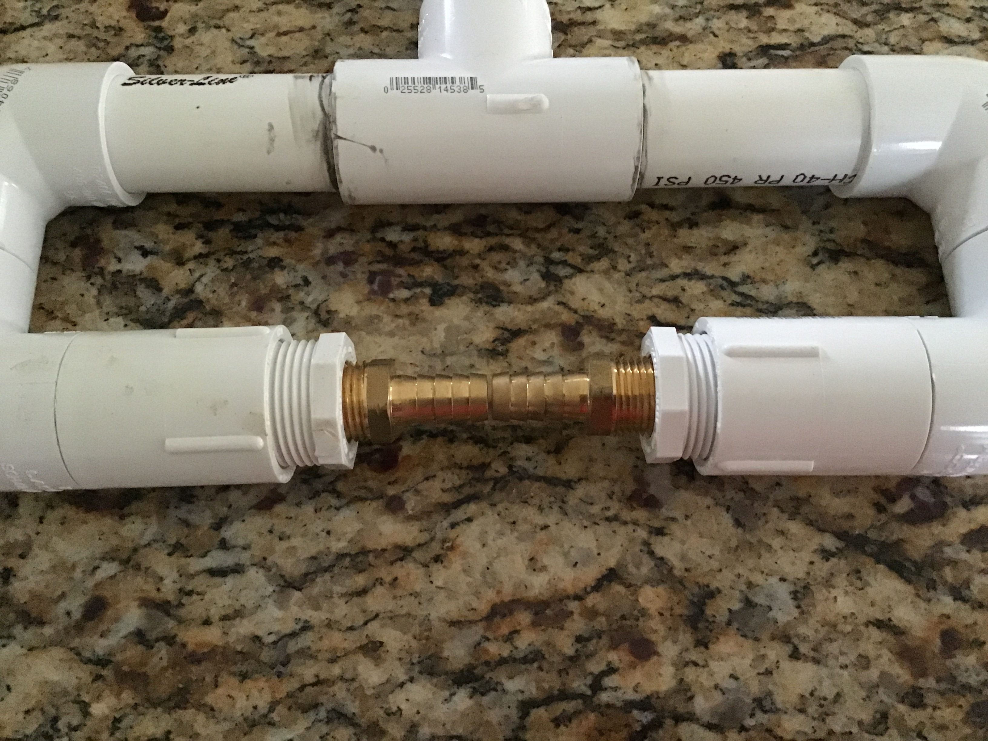

What should I position the spark gap distance to?
That'll require some trial and error. Once you get your transformer you'll want to adjust it as wide as possible while allowing it to still fire regularly.
As a side note, you seem to be using brass fittings. Be aware that the firing of the spark gap will melt and eat away these electrodes very quickly. You will probably need to replace them frequently.
Think stinks, I think I can separate them 1/2 inch max hope that’s enough. Also what metal would you recommend besides tungsten for the electrodes?
A very general rule of thumb is 1.1kV/mm of spark. If you have a 1cm gap, you would need about 11kV. Now this is extremely rough and will depend on humidity, height above sea level, air cleanliness, etc., but what I'm getting at is that I think 1/2 inch will probably be fine for what you're doing.
Anything with a high melting point is good for spark gaps. That is why tungsten is usually selected - it has a very high melting point so it stands up in high-temperature applications like spark gaps very well. However, I realize tungsten can be very expensive, so you'd probably be good even with basic stainless steel. Watch out for galvanized steel though, that will emit some nasty fumes.
