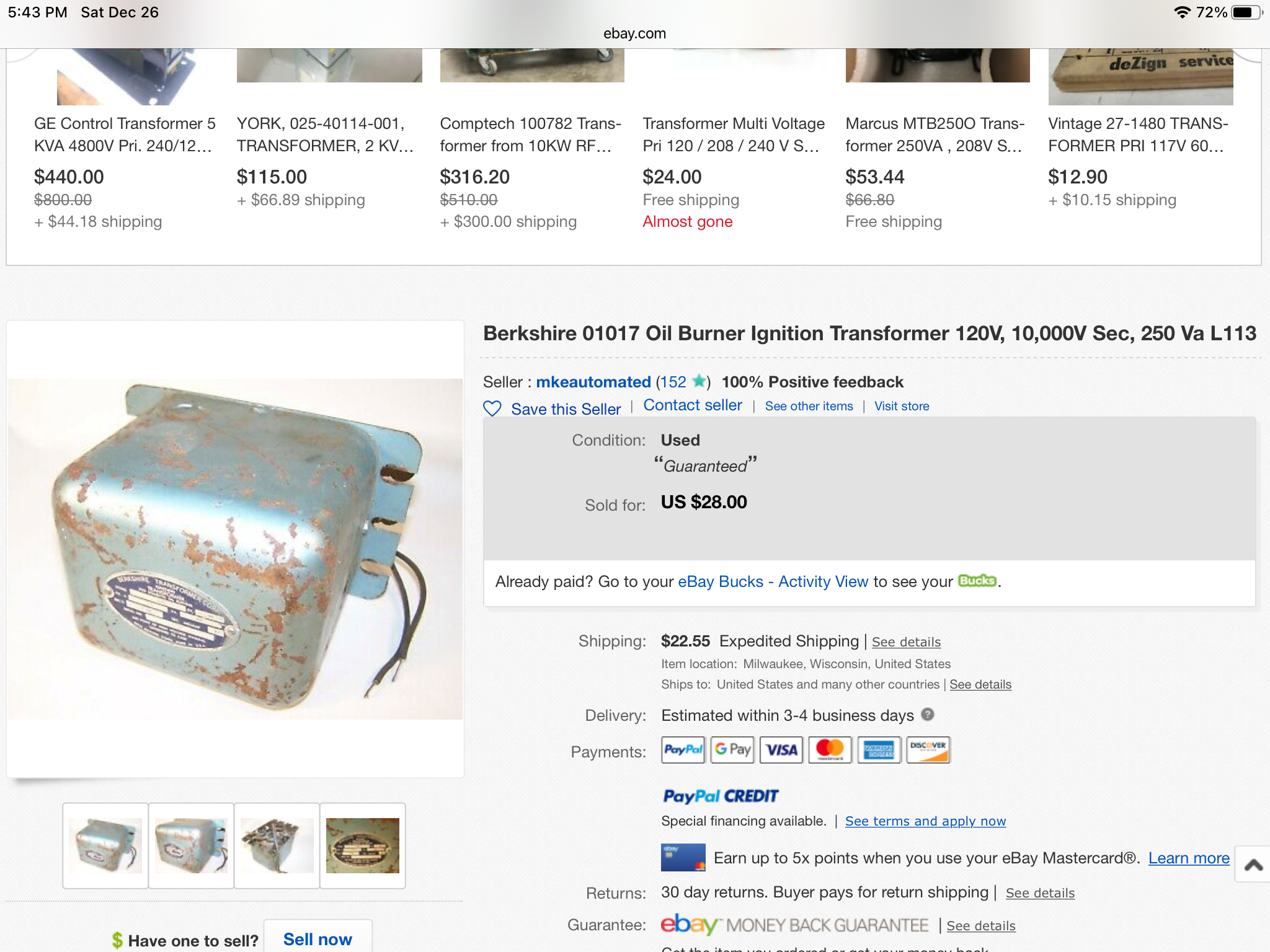

Alright I bought a 10k volt 23mA oil ignition burner transformer and am on the lookout for another one of the same rating.
Awesome! That should at least get you started. It's no beast, but it should be enough to get you a spark. Could you post a photo please?
Looking good!
what kind of amperage would be suitable for my tesla coil? The output for the one Oil ignition transformer is 23mA at 10,000 volts. Would another of the same rating work when in phase or should I suck it up and get three?

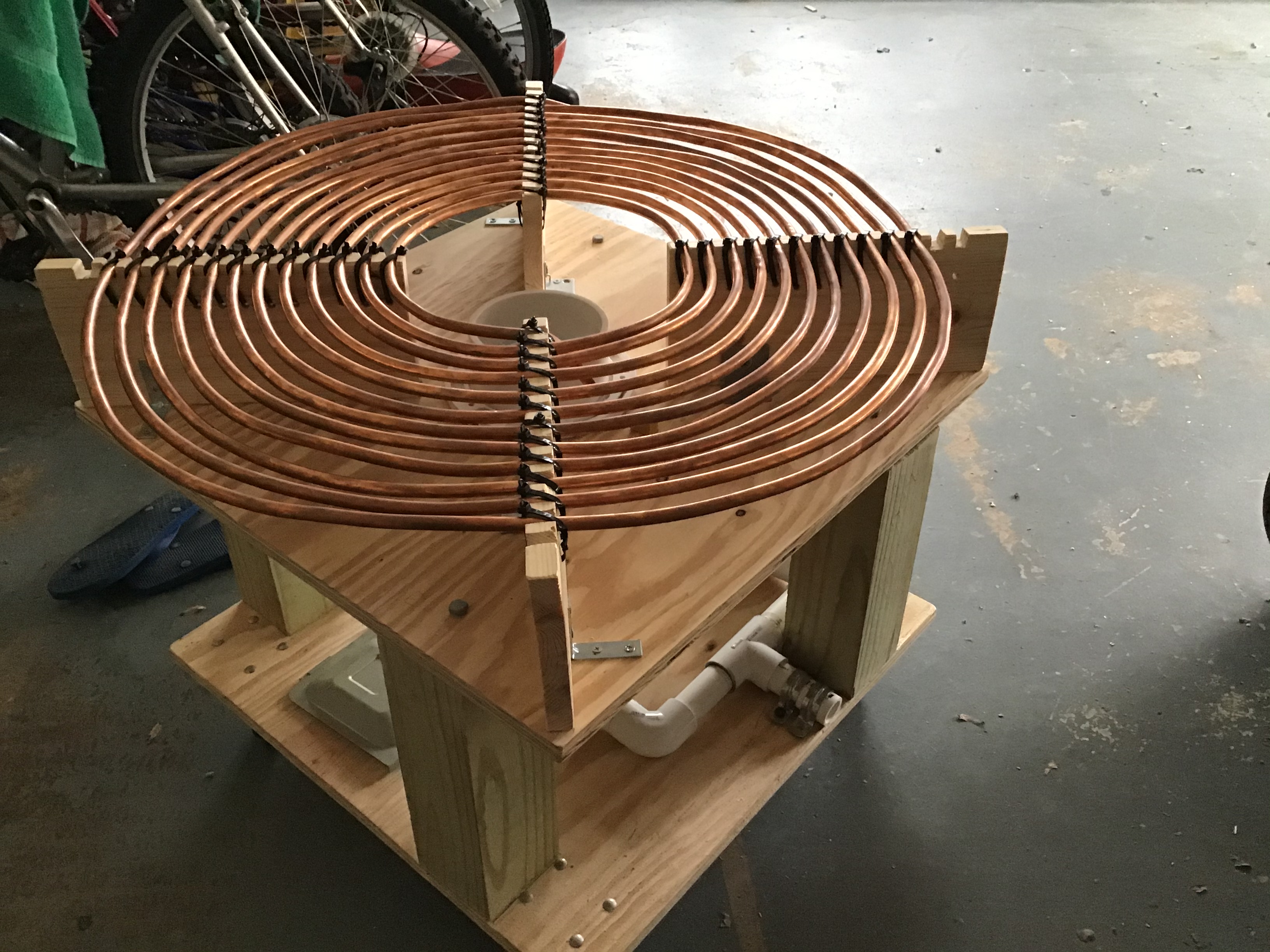

Also does anyone know of a way to prevent the copper tubing from rusting? It already has a coat of oxidized copper and just didn't want it o go any further.
I'm afraid I don't have an answer for that. That would be a good question for a chemist.
Polish it, degrease it and give it a coat of polyurethane varnish.
Varnish is probably a bad idea for a tesla coil, since generally you want it electrically conductive for tapping.
OK, I did not realise it needed a changeable tap.
In that case, sand lightly with very fine abrasive or use wire wool to get it clean, then saturate it with WD-40 & leave to dry (as much as it ever does).
That's what I used to preserve aluminium antennas for amateur radio - no sanding in that case, just let it soak in to the surface oxide. They would stay like new for ten years or more.
I'm guessing skin effect is quite critical for efficiency with the tesla coil, so copper would need any tarnish removing as that is conductive but also resistive.
Rusting? I have some rolls of old copper tubing that belonged to one of my grandpas I've had it since shortly after he died, when I was 14. I'm now 73, and while it's not "bright" now it isn't oxidized to any real amount. Are you sure it is rally copper tube, or is it copper plated steel? There was a time that some car brake lines were copper plated steel, could you have some of that?
