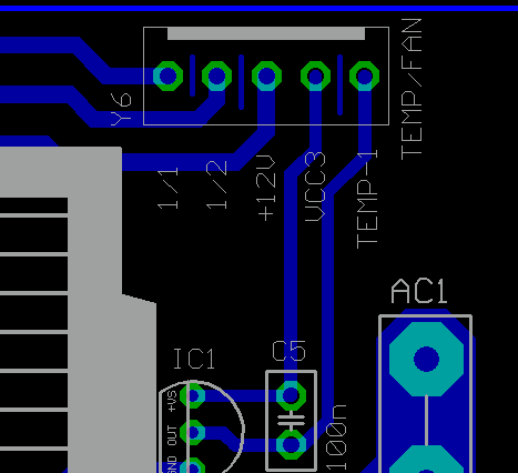

How can I view net labels on Eagle PCB layout ? Thereby I can easily identify supply & ground nets on the PCB Layout without cross-comparing with its schematic.
I turn-on all the layers in PCB layout, but except net labels all others are visible !!!
You place the net labels with either the command 'label' or click on the icon that says label.
Actually in my layout layer list $VCC ,$GND layers are not listed.
Hi vinodquilon,
nets can't be labelled in the PCB layout.
Here's what I do to make PCBs userfriendly, labelling connector's nets, e.g. VCC, OUT and GND:
Use the eye symbol and click the desired trace. The net name will be displayed at the left hand bottom of the screen.
Change layer -> tNames(25), change size -> 0.04'' (1.016mm) and Ratio ->6 (normally 8).
Select "Text" and type the text into the window, then place the text where you want it to appear.
You could also use tPlace(21), but disabling tPlace layer will also blank the written text.
Here is an example.

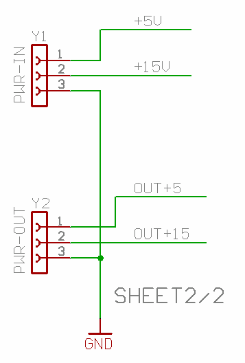

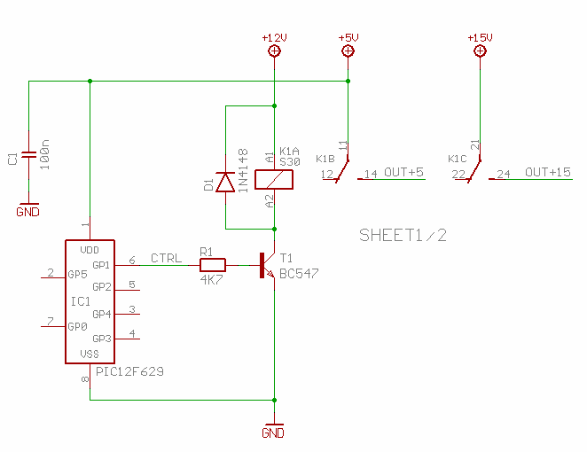

There is one more doubt, How we can cross-reference one relay across different sheets. My aim is that, relay is energized by
the circuit in first sheet but its coils act on a different section in another circuit.

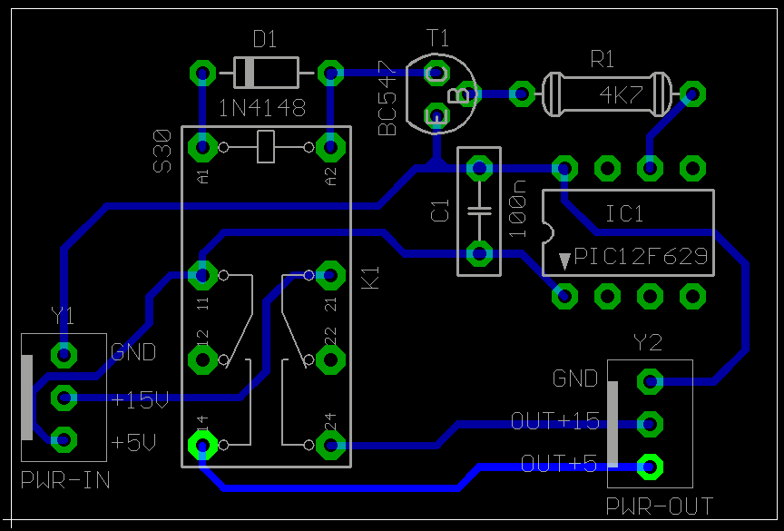

Hi vinodquilon,
that's an easy one provided the relay is located in one schematic (on a different sheet).
Name the net you want the relay to connect with, e.g. "V+in" and "V+out".
Here is an example switching two different voltages with a DPDT-relay. The NO-terminal nets on sheet one must have the same label as the ones connected anywhere on sheet two.
To make sure the connection is intended Eagle will ask you if they should be connected.
When switching to "board" connections are as given.

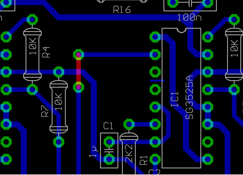

A double sided PCB normally requires plated through holes if a component has to be soldered to the through hole.
You can avoid double sided PCBs by planning for wire jumps, connecting two points across another trace. (see screenshot)
Single sided boards are also cheaper to manufacture than double sided ones.
