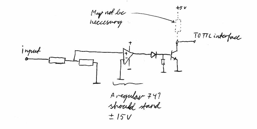

New here. Help with design of logic circuit wanted
so all I need is a comparator that accepts a common mode input voltage equal to the positive supply voltage.
any hints?
any hints?
I have drawn this scetch.
