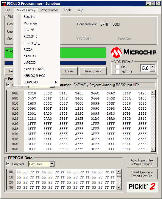

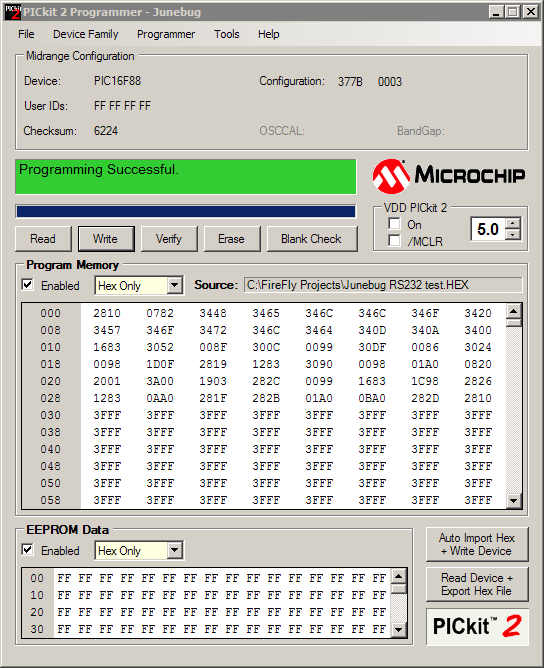

The Junebug only programs / debugs 5V parts including many EEPROMs. The genuine PICkit2 has the clamps and programmable VDD parts for 3.3V PICs.

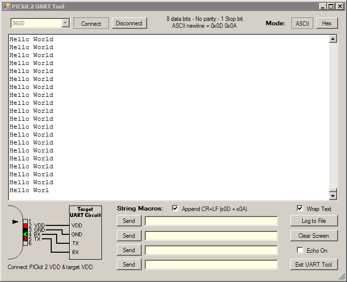

Just testing the Junebug 16F88 using the UART Tool in the PICkit 2 software, this is all possible by only turning off the Tutor switches and turning on the TX & RX switches.

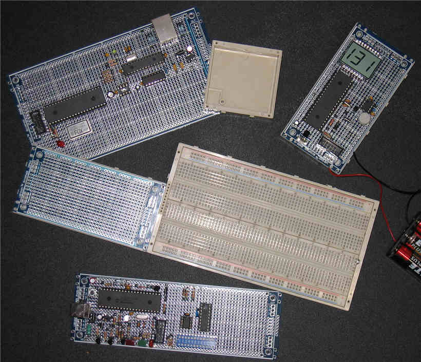

The last photo is some of the LAB-EASY boards. These are teriffic for prototyping with breadboard.

Bill where do you get your blue proto boards and how much do they cost?
I cant WAIT!!!!!!!!!!!!!!!!!!!!!!!!!!!!!!!!!!!!!!!!!!!!!!!!!!!!
Well if you make hundreds or thousands of PCBs they can be pretty cheap. The blue or any color aside from standard green adds about $0.50 to each PCB. Other cool standard colors are Red, Black, Yellow, White.
