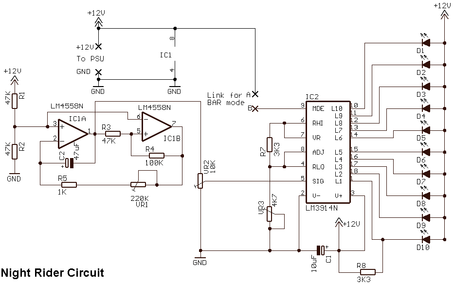

https://www.bit-tech.net/modding/2002/06/22/knight_rider/2 ... granted this was posted back in 2002 and i find that LM4558 dual opamp IC shown is no longer in production. So my question is this, could i substitute it for a LM1458 chip and instead of using the shown 1/2w metal film resisters, could i substitute them for 1/2w carbon type? thanks

use an LM358 instead. The circuit will work fine.
Use 1/4W carbon film resistors.
I used 1/2W resistors 44 years ago with vacuum tubes.
So use the LM358 and 1/4w carbon film resistors as suitable replacements... gotcha. thanks
Ps- I did come accross an MC1458P chip, will that work as well?

Yes you could use the LM1458 or the **broken link removed** which is essentially the same and is still in full production.
Circuit works like a charm with the substituted MC1458 and the the 1/4w 5% resistors. I couldnt find the 15turn potentiometers needed and used single turn instead, harder to adjust and not as accurate, but it works.

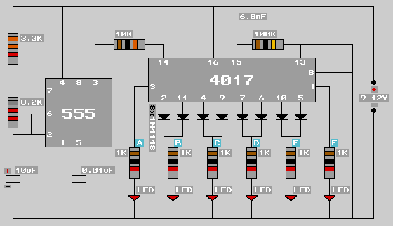

Ok, i finally came across all the required 15turn potentiometers, still a pain in the behind to adjust correctly. So i decided to go with this and used bright blue l.e.ds and i must say, it looks phenominal...

Aren't the 1458, 1558, 4558 all basically multiple 741's? Just about any op-amp could replace these. TL072, TL082 FET input op-amps - and that's just parts available since the early 80's.

Carbon film are noisy but it doesn't matter here.
The 1458, 1558, 741 etc. are all pretty noisy and slow but that doesn't matter here.
The TL072 and TL082 would both work but won't make any difference here.
