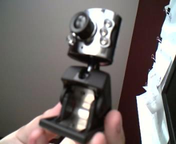

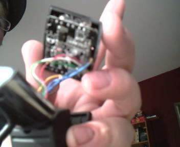

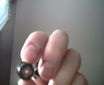

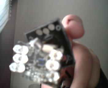

here are some pictures of the webcam that finally came in the mail, it looks like i could easily pop out the IR cut filter because its not directly over the lense, would it be possible to cut the viseo wires and connect them to an analog video cable? i know it would be possible but would it stream video like a regular analog cable? im trying to avoid buying another camera, so im wondering how to make this one work, any ideas would be greatly appreciated, thanks.

What are you assuming is the IR cut filter? The camera's video decoder likely either is or is directly connected to a data encoder that transmits the information via USB, there is no reason to convert it to a standard video signal in the first place, so it's not likely to have any source of composite video signal. It's impossible to tell because the pictures serve little more purpose other than as a gross physical description of the device.
Look for the largest ICs on the device give us their part numbers and take a few high resolution in focus well light pictures of the board (both sides) and there might be something else to say.
If they are IR leds, you don't need to take out the IR filter... Because there is no IR filter on your lens!
On a cheap webcam like this there may be no need for one, the IR cut filters are mostly for outdoor photography, as plant life in particular and the sky itself look dramatically different in the near IR band.
