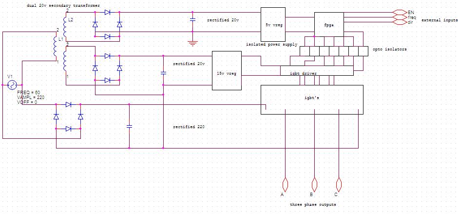

Hello All,
I am currently working on designing and building a basic Three phase AC motor drive using V/F and PWM. I will be controlling the drive with a FPGA and I am ready to begin testing with hardware. The motor I am currently designing for is 2.2Kw 3HP spindle motor that is rated 24,000RPM @ 400Hz 220V.
I am using and Fairchild Semi SME6G15US60 IGBT module for switching the output three phase. With a International Rectifier IR2136 3-phase bridge driver for driving the IGBT's.
I am running into many questions when considering power supply design. I need to rectify the incoming line power and feel that isolation from mains is not a viable part of the design for the following reasons.
-Isolation Transformers are too large and expensive when using this much power.
-Boost / Buck regulator would be nice but too inefficient.
-The DC bus, three phase output, and other non-isolated voltages will be enclosed once the project is finished. Not accessible for touching...
-The logic side of the drive can be opto-isolated from the power electronics. So all logical inputs / outputs, controls, and processing can be run off a separate isolated power supply.
I feel confident in the safety of the design however I understand the potential danger of the situation and would like some feedback if possible.

perhaps a rough drawing would help,

Yes indeed, you can run your project on a non-isolated supply. All VFDs run that way.
Be sure to include:
-fuse the 3 AC input lines
-fuse the DC output line
-EMI filtering at the 3 AC input lines
-Transient voltage suppression
-provide lots of clearance between the exposed conductors and chassis or mounting screws

I burned out the driver, IGBT pack, and FPGA dev board as far as I can tell. :-( I am assuming this is from spikes in the bus voltage from the arcing across the Variacs coil. However can anyone think of what the second arcing noise could be? I have yet to implement any transient voltage suppression as Schmitt trigger had suggested, could this be due to lack of that?
I certainly plan on using more isolation next time between the FPGA and gate driver however what else can I implement to make sure this does not happen again?
Sounds like something shot through the base of the IGBTs, through the drivers and into the controller?

Do you have an filter choke & cap on the DC input? Basically make a surge suppressor before the IGBTs.

There is currently only a large filter cap on the DC bus after the bridge rectifier. I'm trying to think of how exactly to go about sizing a choke for this setup.
Most of the smaller VFD's I have dont have a filter inductor of any kind. Some bypass capacitors over every switching device and thats about it.
Your IF2136 Driver IC shares a common line with all of the control circuits. It likely dumped a load of noise back through to the control system that way. Better bypass and surge protection is needed.
Being line driven there is also the possibility that one of your power sources for the control system is set up with bypass circuits that take the low voltage and couple it to earth ground.
Your drive frequency may be wrong and creating a harmonics mess on the system too. I have played around with designing small VFD's before as well.

So there are just caps before the switching transistors and that's it? I may try to pull a choke from an old PC power supply. I am also expecting to eventually need an inrush current suppression circuit.
I was powering the control system / the dev board off a isolated 6V bench supply that was not tied to ground. However the 3.3Vand 1.2V regulators on the board were quite hot and so I assumed they had been destroyed by a VCC voltage spike of some sort.
How would a voltage spike possibly from the Variac affect this isolated supply when only the negative sides were tied?

Being the common and the output tap with the arcing are supplying the power. Bridge rectifiers will pass high voltage spikes without problems.

Do you have snubber caps on the IGBTS?
I'm running out of ideas now. Back to noise in the system, which is such a nebulous problem.
The common ground is about the only thing different from mine it seems. That bugs me. I don't know enough yet. :(
smanches,
So yeah I was not using any snubber caps or transient suppression of any kind, so I learn the hard way. This could explain the lower frequency arcing I was hearing, could it have been arcing inside the IGBT pack?
I have never had a real need for snubbers before, so this is new to me. I found an IEEE article I am going to read through.
I am assuming you are using some on your H-bridge, how did you go about sizing these?
