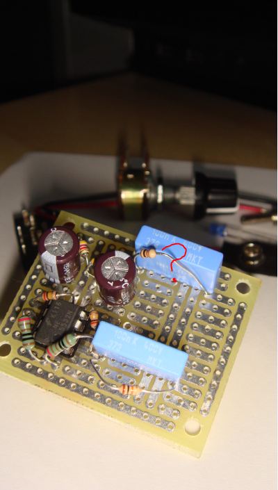

Hey guys..me and my dad have started bonding more recently and its his birthday in a few days and i want to make something with him...
he bought me some parts to make a Cmoy headphone amplifer...but the tutorial on the website has a differnt board...so i cant follow the tutorial ....instead i will have to make it by looking at the schematics...
ive never made anything like this before but really want to learn and this will be a great step into DIY electronics...
if some1 could help me set this up so that me and my dad can build this i would really appriciate it...
ok so..here are the schematics

THESE ARE MY PARTS
the pic shows
2 electrolyrtic caps 200uf 25v
2 0.1 uf polypropylene film caps (the blue ones) on them it says 400v 100nk :S
dual op amp
and the board
You are running off two 9V batteries, you could not possibly need 400V caps and you don't need polypropylene or polystyrene caps either. Just use 0.1 uF ceramic caps (25V or higher) and they will work and they are about 1/2 the size of your smallest fingernail.

I am an audiphile, but I can still absolutely guarantee poly caps do not sound any different than any other good, wide band cap like an MLCC (multi layer ceramic capacitor).

About the "400 V caps", you could call this a 'conservative design'? they'll never "break down". Some of my first projects often used surplus parts that would of been destined for things like hoovers
