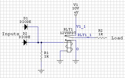

Ok here is my Rube Goldberg no pullup NOR gate. Hope glitches are okay... lol
Yeah, I did not bother changing voltages to TTL. Lazy...

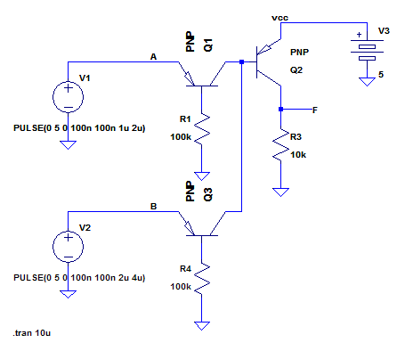

You can do it with PNPs. You may recognize it as the PNP version of the TTL NAND gate, with the logic levels inverted (0=high, 1=low). If you float an input, the result is the same as if the input were grounded.
  • PNP NOR gate.asc
Ok, yours is better, but where is the chicken wire? Mine had a rubber band for the relay :)
I know, I was much too serious. I didn't get started on my design until I could get up off the floor after looking at yours.:D

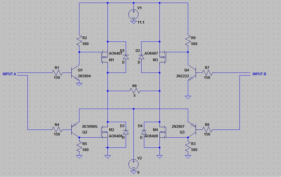

I am trying to build a circuit for a radio controlled car that allows me to supply 6 or7 volts to the stock electronics package but 12-15 volts to the motor. I cannot simply feed 15 volts to the stock electronics as they will fry. The original discussion of this project can be found on this forum here.
So the plan is to feed the stock electronics with a voltage regulator and take the pulses from the stock H-bridge, that were originally destined for the motor, and pass them to a circuit that would trigger a second H-Bridge capable of handling more power. The original circuit diagram is attached (Version 1)
The outputs from the stock H-Bridge are inputs to the circuit I am trying to build and are as follows (these are pulsed from float(?)):
A high, B low = forward
A low, B high = reverse
A low, B low = brake
A and B off (float) = coast.
The problem I came across was that in version 1, the PNP inverters (low side) were driving the input lines to these inverters high which triggered the input line to the NPN inverters that drive the high side. I set it up this way because I was thinking of the brake function (both low inputs would trigger both N-MOSFETs on the low side). I did not forsee the PNPs having high base states. So this circuit does not work.

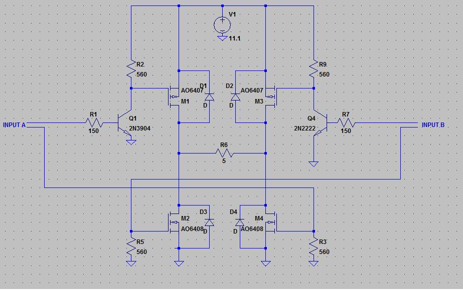

I re-worked the circuit to what you see in version 2. This works just fine, forward, reverse and coast, and I am quite happy with it. However, I have no brake function. I thought that if I could come up with a NOR gate with floating inputs then when both inputs are driven low, I could independently trigger both low side N-MOSFETS via some sub-circuit. Thus my search for a NOR gate with floating (rather than high) inputs.
Mikebits, will the output of your "Rube Goldberg" NOR gate be high if both inputs are low?
Yes, but don't use my circuit, I was just being a smart alec. Although you could use the diode OR part + resistor with an inverter. Floats would appear as no current, output would be high.
Were you laughing? My goal, make someone giggle or chuckle once in awhile :)

If you examine the Version 1 circuit that I have posted above you will see that to switch the low side N-MOSFETs I have used a PNP Inverter (low in -> high out). The inverter itself works fine independently but it causes havoc when combined (at INPUT A) with the NPN inverter on the same side of the bridge. Because the input to the PNP inverter is pulled high by default (awaiting a low to trigger it) it automatically triggers the NPN inverter. I guess what I am really after is an PNP type inverter (low in, high out) that does not require the input to be pulled high by default but rather lets it float.
Thoughts?
