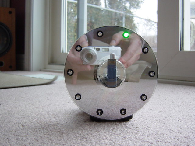

Yes, I mounted my chasing LEDs on CDs (CD Roms from an ISP).

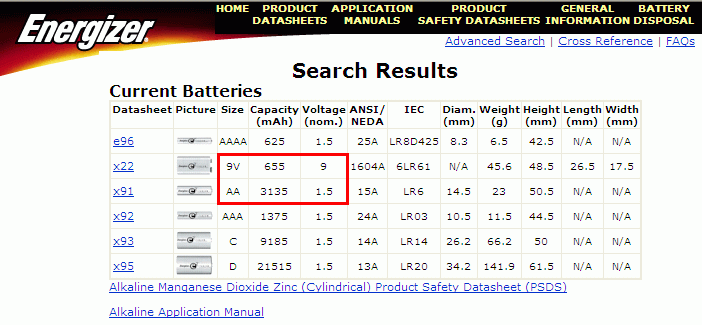

Have you seen what's in a 9V battery? Six very small AAAA cells are in new 9V batteries.
My chasers use 74HC4017 ICs and ones using ordinary red LEDs use only two AA battery cells that are much cheaper than a 9V battery but have 5 times the capacity, for nearly the same size.

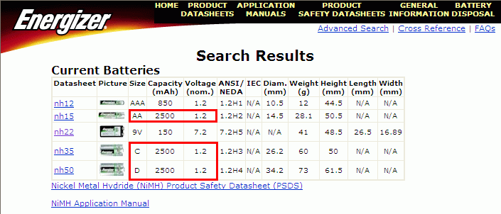

Watch out when you buy expensive Ni-MH rechargeable battery cells. You want a high capacity battery so you buy big C or D cells. Your circuit doesn't run very long with them. You look them up on the battery manufacturer's website and find that there is only a little AA cell inside!
