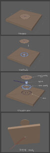

I have no experience with electronics of any kind. I would like to buy or build 3, low profile, motorized rotating display disks for a display case. You can see the mockup for the display case attached.

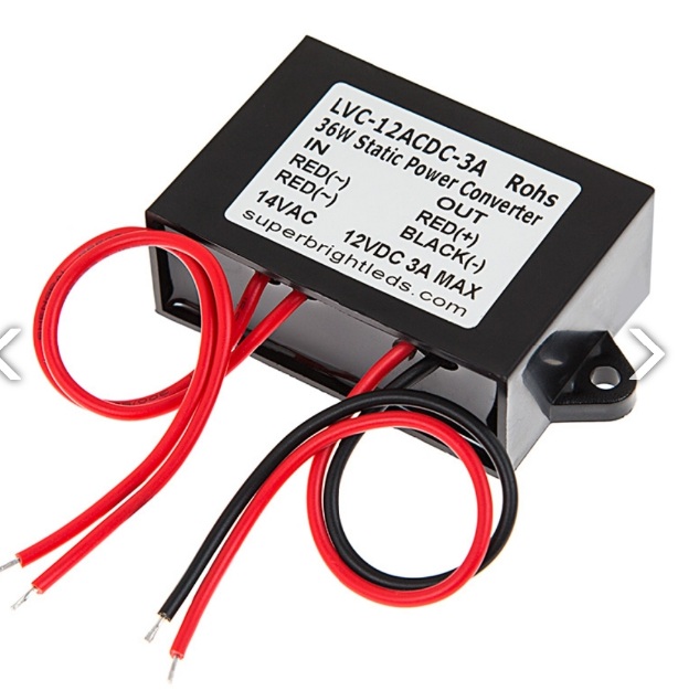

Thanks Mike. I appreciate your great response- When you say "3a" are you referring to the wall wart? Do you have a link to a wall wart you recommend? Also, do you have a switch you recommend that can control all three motors and then connects to the wall wart? Not sure if thats the best way to connect everything. Anyway thanks again Mike.
One problem will be finding a beefy 3 volt power supply for those motors. 5 volt supplies are common for USB devices, 6 volt and 12 volt supplies also common. With a motor designed for higher voltage, lower current will be required to get the same power from the motor.
The power supply will have positive and negative connections, which will be connected in parallel to all three motors.
I suggest switching the AC input (line input) to the power supply unless you may want to control the motors individually.

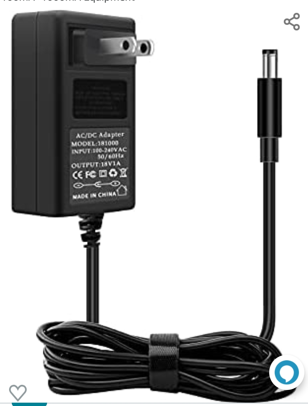

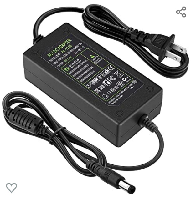

"Wall wart" = power supply = 120 (or 240*) VAC to low voltage DC (whatever voltage the motors need),
* Line voltage depends on where you are.

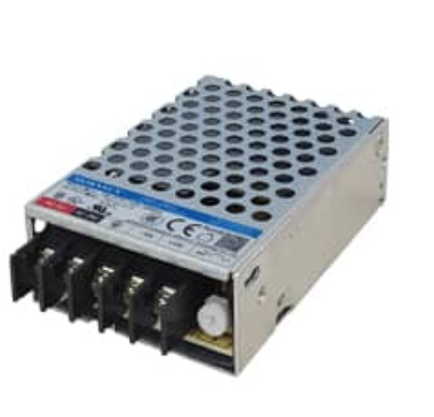

Power supplies can be in many forms – here are a few examples. The type with an attached or plug-in line cord would probably be best to reduce the line voltage connections to be made.

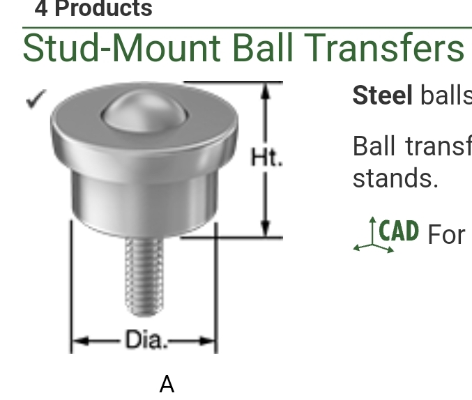

To support the platform, something like this "ball transfer" from McMaster-Carr might work well. Three of these positioned near the rim of the platform would provide solid support even if the mass on the platform wasn't completely centered.
These are available in many different types and sizes.

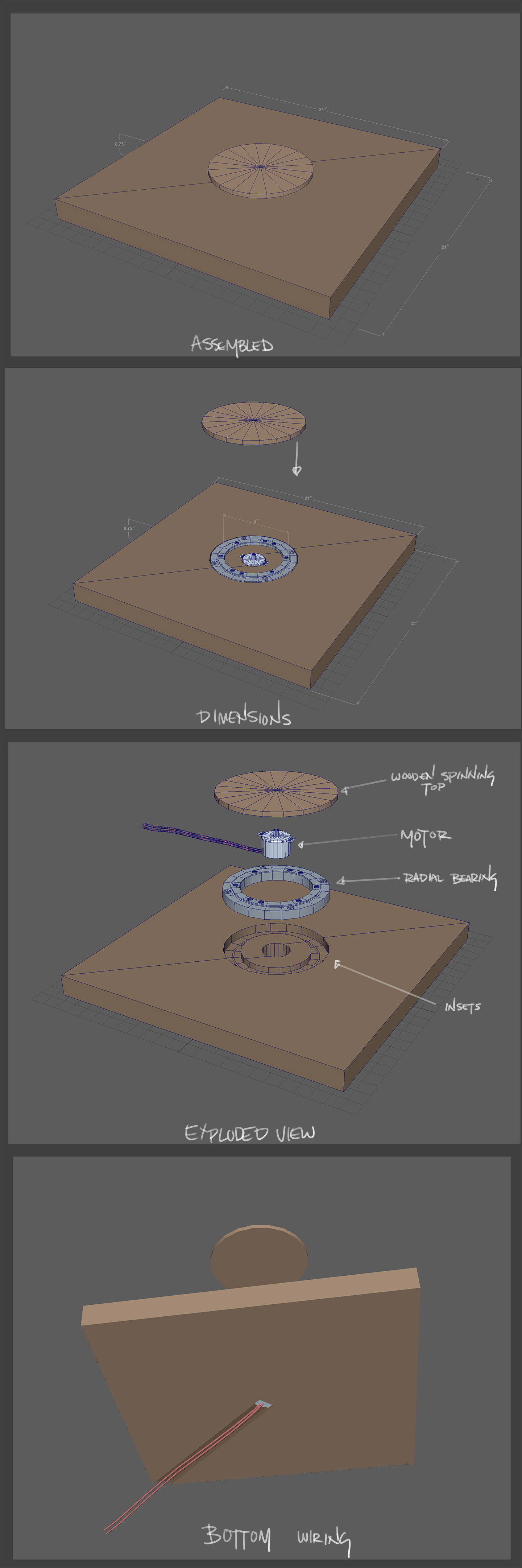

Unfortunately I cant do a box as I have a height limitation on the display area. This is going in an office that wont allow over 79" tall on the overall case, and I need each display area to be at least 24". I do however, have the platform supported by a radial bearing. As seen in the attached. Do you feel like that would suffice, or would the ball transfers still be required?

No, you can't use a potentiometer - use mechanical gearing.
Cool thanks Nigel, the issue here is that I cant find a mechanical motor that is less than 3/4 high, that is 6V, that can deliver enough torque to rotate 30lbs, that is 1 RPM or less. Do you happen to know if one of those exist? and if not, what the next best option is?
