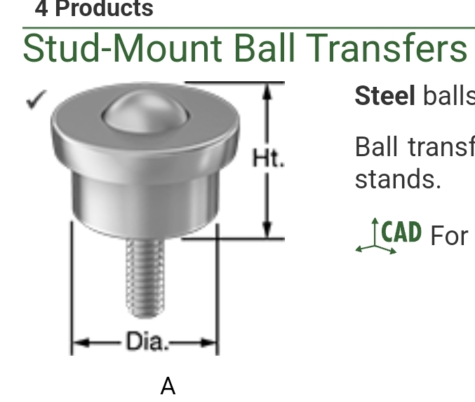

To support the platform, something like this "ball transfer" from McMaster-Carr might work well. Three of these positioned near the rim of the platform would provide solid support even if the mass on the platform wasn't completely centered.
These are available in many different types and sizes.
Having used those type bearings in a work situation, for something just rotating I'd never use them. Unless you can put a groove on the bottom of the platter to guide it. Any off balance off center of the item on the platter will make the platter walk out of a circle.
To keep it rotating in a circle pattern I'd get "lazy susan" bearing rings. They can't move except in a circle. Just something to show what I mean.
