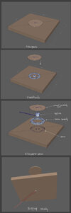

Hello!
I have no experience with electronics of any kind. I would like to buy or build 3, low profile, motorized rotating display disks for a display case. You can see the mockup for the display case attached.
Ideally, I would have the rotating display disks rotate at a slow pace, controlled by a switch built into the display case. If it doesn’t sacrifice the profile, I would like to have the speed be variable and adjustable by a knob on the swtich, with a high bound cap on the speed. The disks will be supporting a series of statues. The largest of which is Width: 20.5” Height: 22.5” Depth: 17” Weight: 30 lbs. Note that I would just buy a rotating display disk, however they are all to high. I can drill into the ¾ inch wood platform the disks sits on to reduce the height if need be.
My primary questions are:
• Ideally, the rotating disk and motor would be less than an inch high, if that isn’t possible, I am wondering what the lowest form factor as possible would be? I am not sure if anyone has any ideas of small form factor motors?
• What are all the parts I would need to buy in order to make this? Do you have any recommendations?
What is the best way to wire everything together?
I am of course open to any and all suggestions, or better ways to build the project. Thank you so much in advance for your time and help, it is much appreciated.

Thank you to all who have replied thus far! It has been insightful to say the least. Due to all of your great input, I have what I believe to be a more sound design (attached). My main concern is still the size of the motor. I am thinking a small DC motor, that has 1 RPM. It is for a display so the thing is great if it's slow. As stated, it has to turn a 30lb statue, with a height of less than .75 inches. I looked into microwave motors, which would work well- many are just .4 inches tall, but they cant turn 30lbs. If anyone has any links to motors they think will work it would be much appreciated.

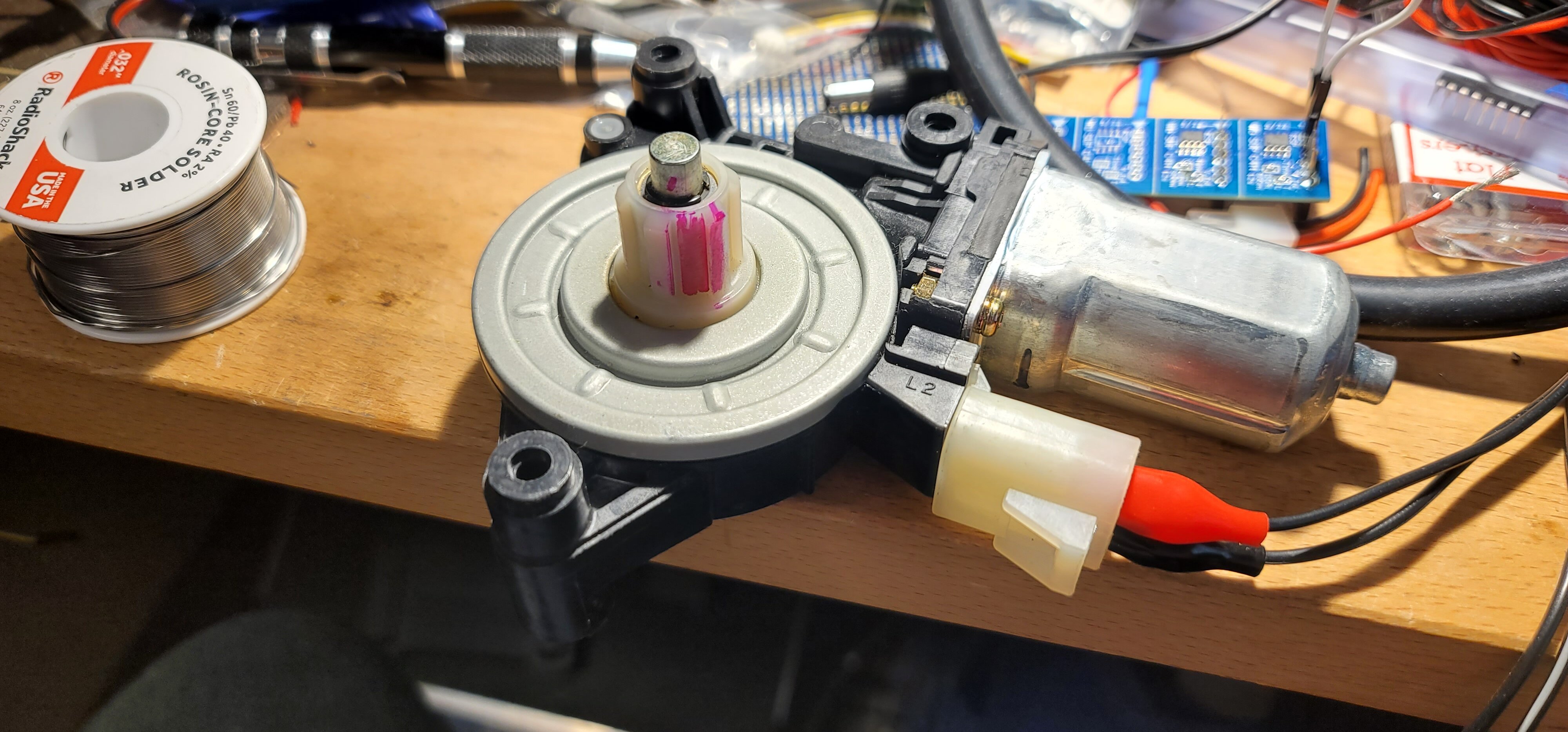

You might consider an automotive power seat motor as shown in the picture – many models of cars use something similar.
They will be thicker than you'd like, maybe 3" thick, but they will rotate a huge mass. They'll run over a large voltage range so the speed can be controlled over a range; if I recall correctly, the speed range would be suitable for a display. I did some tests on one of these I got at an electronics store but don't remember the details.
Here's a video of one of the electric seat motors in action. Let's make it two videos. The first is with ~12 VDC supplied. Probably too fast for a display case!
The second is taken with 1.8 VDC supplied. The motor is drawing three-quarters of an amp to make a rotation in 8 seconds. At this voltage, I cannot stop the motor from spinning or even affect its speed by trying to grip the shaft with my fingers.
Overall dimensions are less than 5" x 7" and about 2" thick to the top of the spindle.
Crap – apparently videos aren't allowed, so a photo is attached.

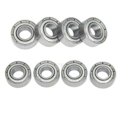

Use ten to twelve small sealed ballraces fitted to "u" brackets or pairs of "L" brackets as support wheels at regular intervals on the base, distributed on two different diameters under the turntable plate (outside the pulley area).
eg.
or
Using a 6mm plate, 10mm bearings with 2mm clearance below, that can give a top height as low as 18mm. Or 20mm with an 8mm plate.
I'd try to keep the bearings on an original uncut surface for accuracy, though you could recess them if you needed a lower profile and can accurately mill the entire area.
Or use straight axles rather than brackets, with the axle attached or clamped to the original surface and just the bearings themselves over pockets?? [pieces of threaded rod with nyloc nuts to lock the bearings in place?]
