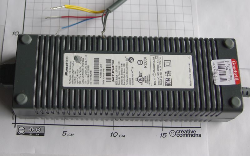

One solution to powering the motor would be an X-Box power supply which can often be found at thrift stores for a few bucks. These beasties will supply 14 amps and some models even 16 amps! Here's a link to my efforts to figure out how to use these guys. In addition to the main 12v supply, there's also a low current 5v supply and a control wire that must be connected to 5v to turn the 12v output on. This may be useful for your app, as a low power switch or a microcontroller could be used to control the 12v output.

I do agree that the larger capacity PS will give you the results you need... The problem here is.. How much would you pay for a decent Power supply.
I would go for a 15A supply... If the motor is old and tired, the starting current will be even higher..

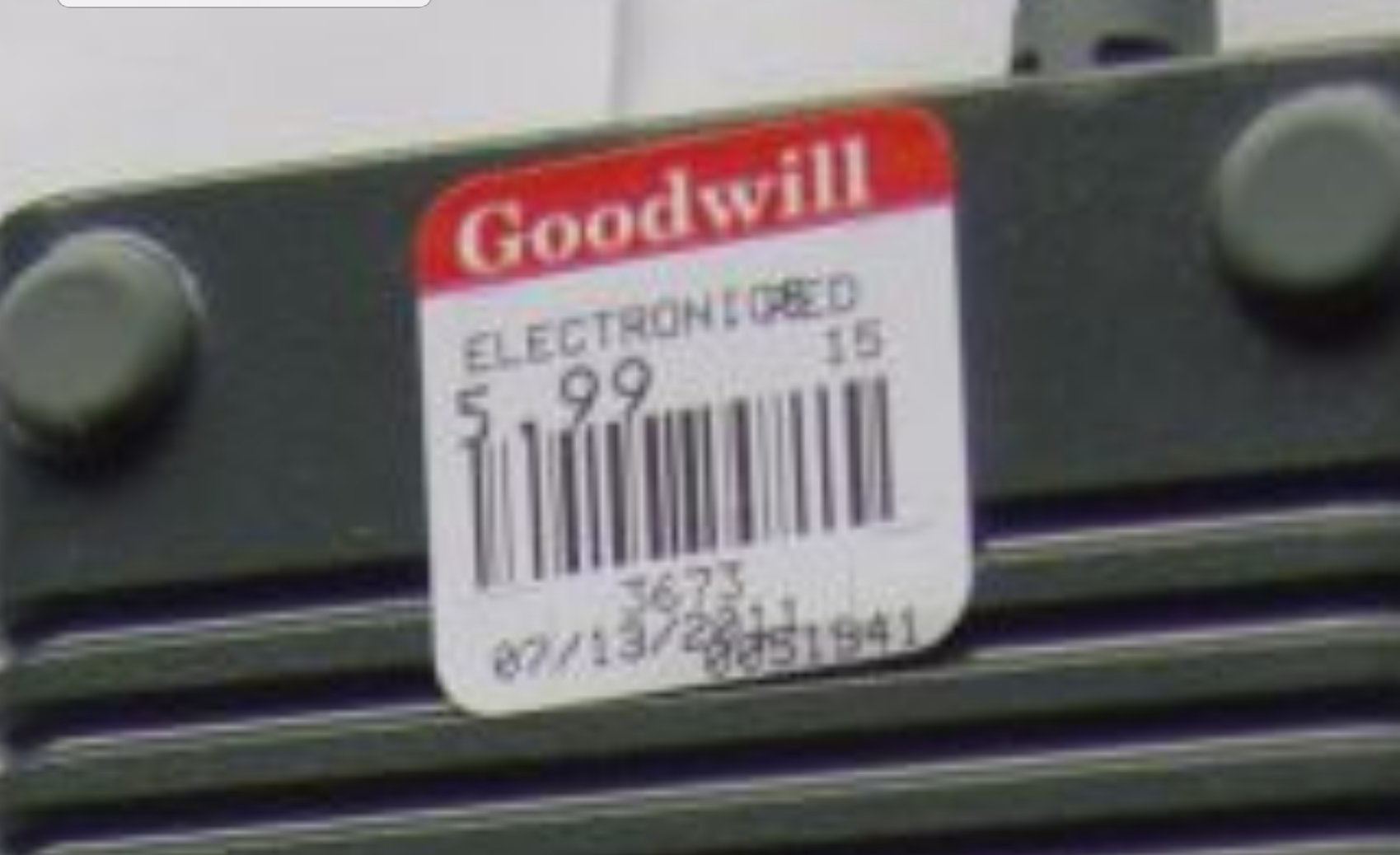

Well, as I posted above, I would pay ~US$5.99 for a 14 - 16 amp XBOX power supply at a thrift store. These things are very common, and the few I have purchased at thrift stores have all worked perfectly. One of the links I posted by people who do all sorts of wonderous things with wiper motors even suggests this exact solution.
