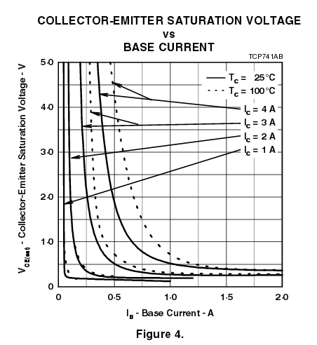

Here is the saturation curves for a high voltage 4A transistor.
You can see that at low collector current the curve has a square corner and at high current the corner is round.
If you increase to B current too much there is more heat in the transistor. 2A x 1V = 2 watts. Also the transistor will get very slow.

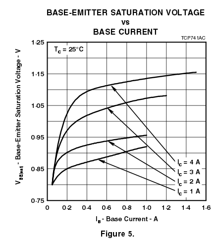

I picked a high voltage transistor to make a point. The B-E voltage is almost 1 volt. This is typical of a high voltage part. The silicon is different.

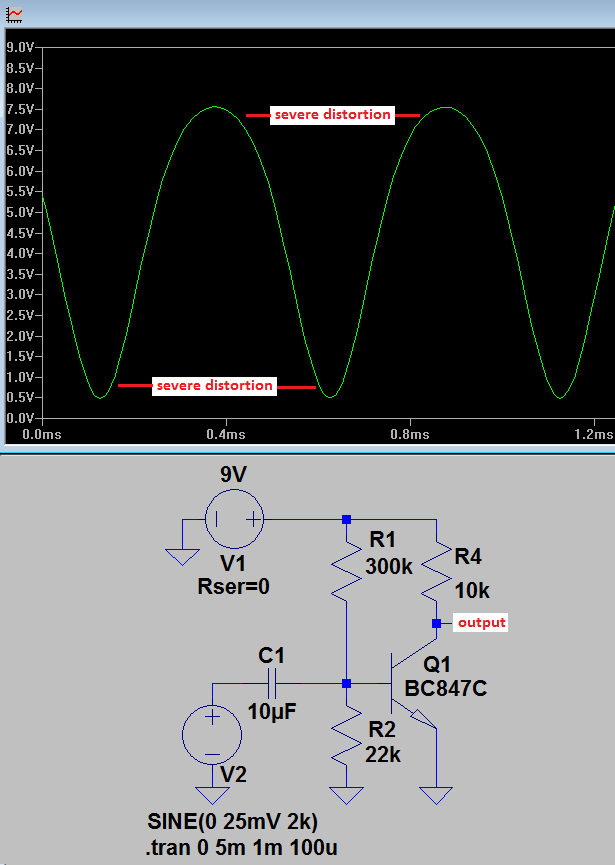

The relationship of Vbe to Ic is exponential.
That is why a transistor used to amplify an audio voltage signal without any negative feedback produces severe distortion at high levels (below clipping):
