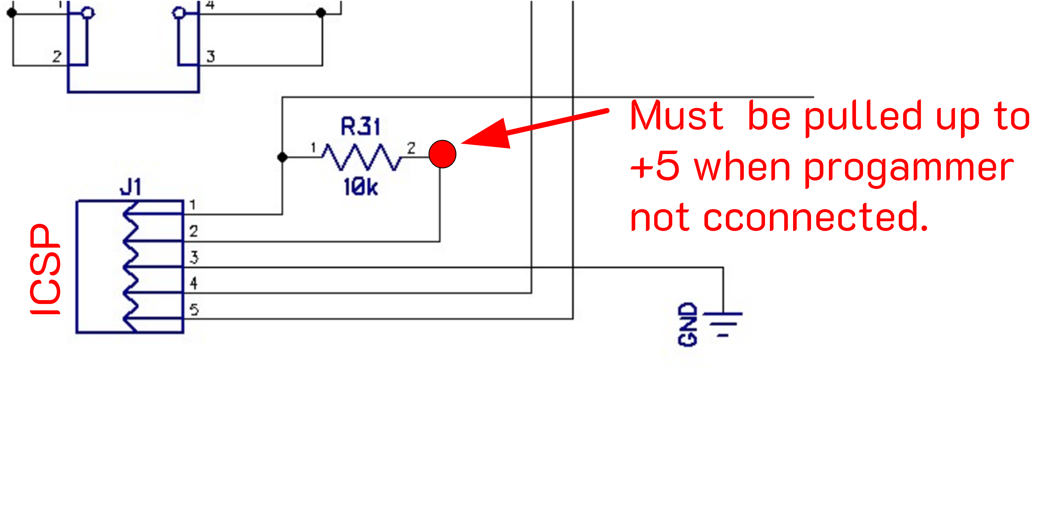

Also, /MCLR must be pulled high. As it's drawn, the resistor is connected to }+5 on the ICSP connector, but it's not connected to +5 of the circuit.
Also, the Pickits look for Vdd or decide it's connected wrong. Or the Pickits must be set to power the circuit, which should work.
Edit, as long as the external 5V supply is maintained.
Another excellent point. I was thinking that it was probably best to leave V+ disconnected because the PICkit 3 can't supply much current. But you are correct – it must be connected for the PICkit to work.
A jumper to bypass the cutoff circuit during dev would be a good idea.
