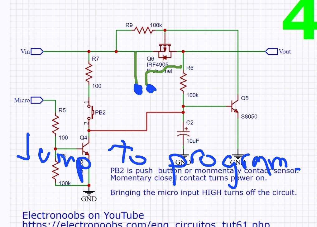

Been contemplating this stupid project and thinking "Maybe:" I need to add an ON button so then the buttons would be 6 unless I can use the START TIMER button to enable the timed latch circuit.
Depress to enable the timed latch circuit then use the same button to start the timer?
NOTE the micro would be powered ON after the timed latch circuit is enabled.

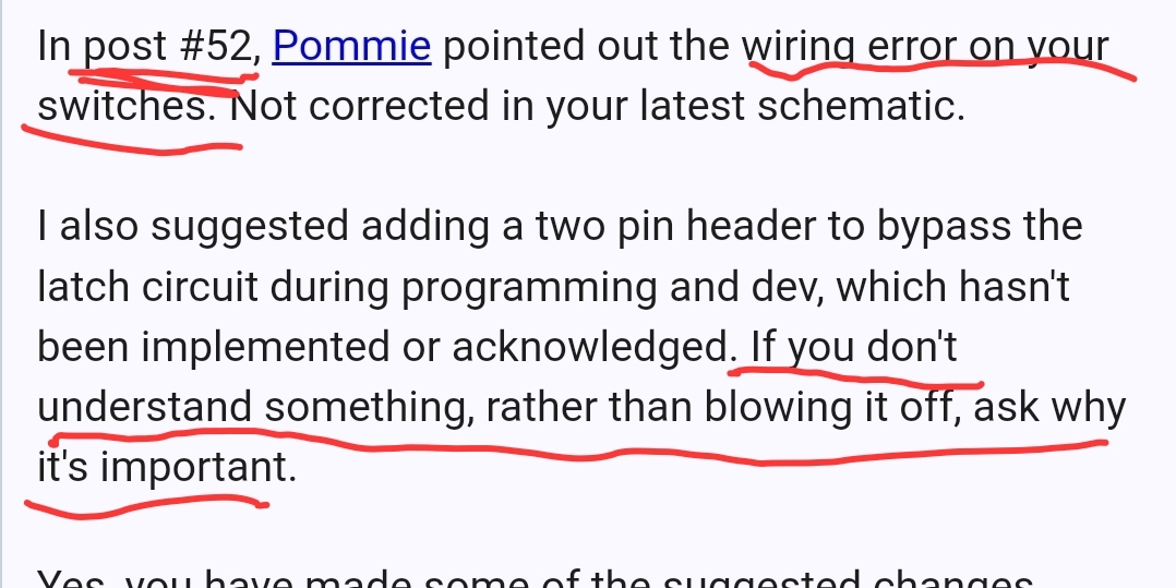

MrDEB , how about trying to make all the needed changes & corrections to your schematics before posting them, rather than adding some and apparently saving others for later? Once again, you have so many different versions posted ain't nobody can keep track of what's what, including you.
In post #45, the latch circuit is drawn correctly.
In post #50, you screwed up the latch circuit. In post #54, I pointed that out. Yet your latest schematic hasn't corrected that error.

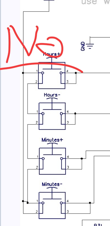

In post #52, Pommie pointed out the wiring error on your switches. Not corrected in your latest schematic.
I also suggested adding a two pin header to bypass the latch circuit during programming and dev, which hasn't been implemented or acknowledged. If you don't understand something, rather than blowing it off, ask why it's important.
Yes, you have made some of the suggested changes (ICSP V+ connection and LCD control lines). Do you expect a gold star for doing so?
I don't mean to be harsh, but I just spent an hour comparing schematics to figure out what changes have been made, fixed or broken. It would be useful to say exactly what you've changed in each schematic. You'll keep track and commenters will know w/o searching.

YES while laying in bed this morning, It dawned on me about the left side of the switches DUH
As for the bypass during programming, this is going to be mounted on a stripboard. IF it works out, then yes will add on a PCB design.
It's fortunate you discovered the error. The board wouldn't have worked as you drew it.
