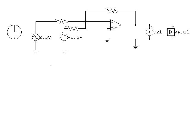

offset
hi all,
i am using dsPIC30f6010 microchip and i would like to know whether the designed offset circuit, (for voltage signal to be in the range (0-5)v if before applying it to the adc, voltage is in range -2.5 to 2.5), is correct and what type of opamp i have to use here?sorry i forgot to put the zener diode at the o/p of opamp.
how should i get the -ve voltage for -2.5V
thank u

If you only have a single power supply rail, eg +5V, then you want an opa that is designed to work with a single supply.
The two opa's that are in common use are the LM358N and the TS358.
The TS358 is designed to enable the Vout to swing to ground.
To get the full Vout swing you should supply the opa with a higher voltage than +5v.
These two opa's are about 25pence in UK. [ they are dual opa devices]
Eric

EDIT:Use the TS358 opa, the +/-5Volt psu will be OK.
Let me know what you are using the opa for and what is going to the
input device. I maybe able to help you with a drawing.
Eric

i am using dsPIC30f6010 microchip .for voltage signal to be in the range (0-5)v if before applying it to the adc, voltage is in range -2.5 to 2.5V, and what type of opamp i have to use here
hi
Checkout the attached drawing, OK as a starting point.
NOTE: the output from 'B' is 0v to -5V. for your reference only, use 'A' for the PIC's ADC.
Work out for yourself, how to use the second opa stage, to get the Vout signal to the correct sense.
Eric
thank u very much for ur support.
i am using dsPIC30f6010 microchip . for voltage signal to be in the range (0-5)v if before applying it to the adc, voltage is in range -2.5 to 2.5V (i.e nearly sinusoidal with peak-peak amplitude of -2.5v to +2.5V). I got this range of voltage after scaling down the sensed voltage( or current) using voltage (or current) sensor. now please tell me whether i can use the proposed circuit by u?
Use the first half of the opa circuit.
The Vout on 'A' will be close to +5V when the input signal is -2.5V and 0V when the input signal is +2.5V.
You do not require the second half of the opa, I have shown it connected in order to identify the pin out for you.
You can use it on some other way, if you have a need for a 2nd opa.
Eric
