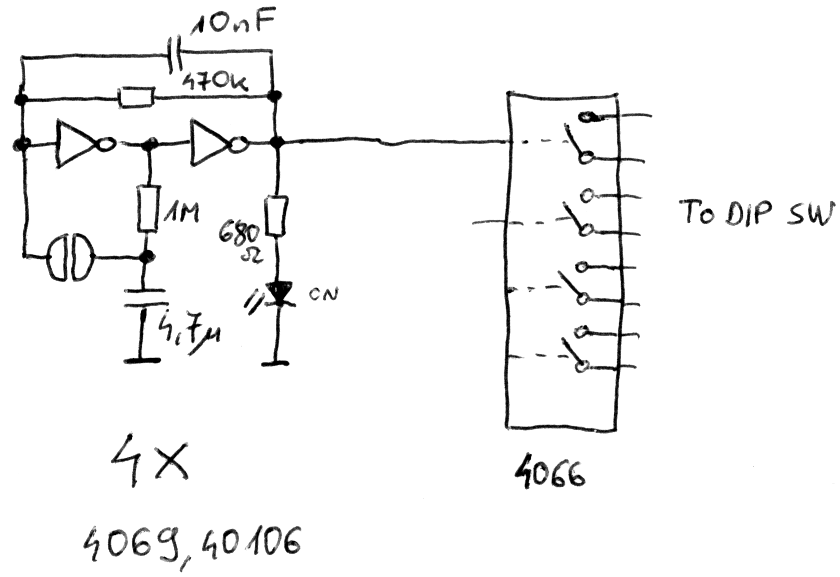

Another solution...
Yes off course.(I`ve drawed quickly, maybe not clear...) The first stage with two inverters multiplyed by 4. CD4066 contains 4 analog switches,but this output stage no need, when You can discover the DIP switches: e.g. DIPSW go to some digital input and connect it to GND against a pull-up resistor. (4066 can work up to 15V)
Common problem with these circuits the "after power-on state". If DIPSW definied (e.g. for a processor) different program start and make the read-out cycle only after reset procedure,the switches must be in desired ON or OFF position before the supply switch on.
