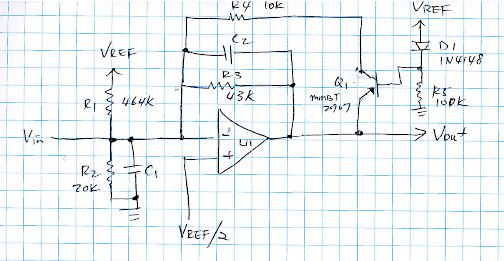

I recently ran into to an OP Amp circuit in which there is a strange negative feefback path that just I counldn't quite figure out what it supposed to do. Would someone please take a look and tell me what could be the purpose of R4, Q1, D1 and R5 circuit doing in the OP amp feedback path? Thanks!

Just taking a wild stab... Looks like the transistor is supposed to turn on if Vout goes above Vref, which will pass current back to the inverting input and reduce the output; so it's a clamp (keeps Vout below Vref). It might actually clamp the output a little above or below Vref as the diode voltage and transistor Veb won't necessarily match.
You are probably right. The same VREF goes to the ADC REF, I think it's meant to protect the ADC input. I am just wondering why doing it this way instead of using clamping diodes at the input of the ADC.

It would help to know where this circuit came from and what it is supposed to do.
The transistor will limit the output without distorting it as much like a clamp diode would, or provide a softer clamp.
Without knowing that this entire circuit is used for however, it could even be a very crude triangle to sine converter for example.
Yes the circuit is a clamp.
To a first-order, D1 compensates for the base-emitter voltage of Q1.
They use an active clamp instead of a diode because the clamp has a more accurate and sharper clamp point then a simple diode by itself.

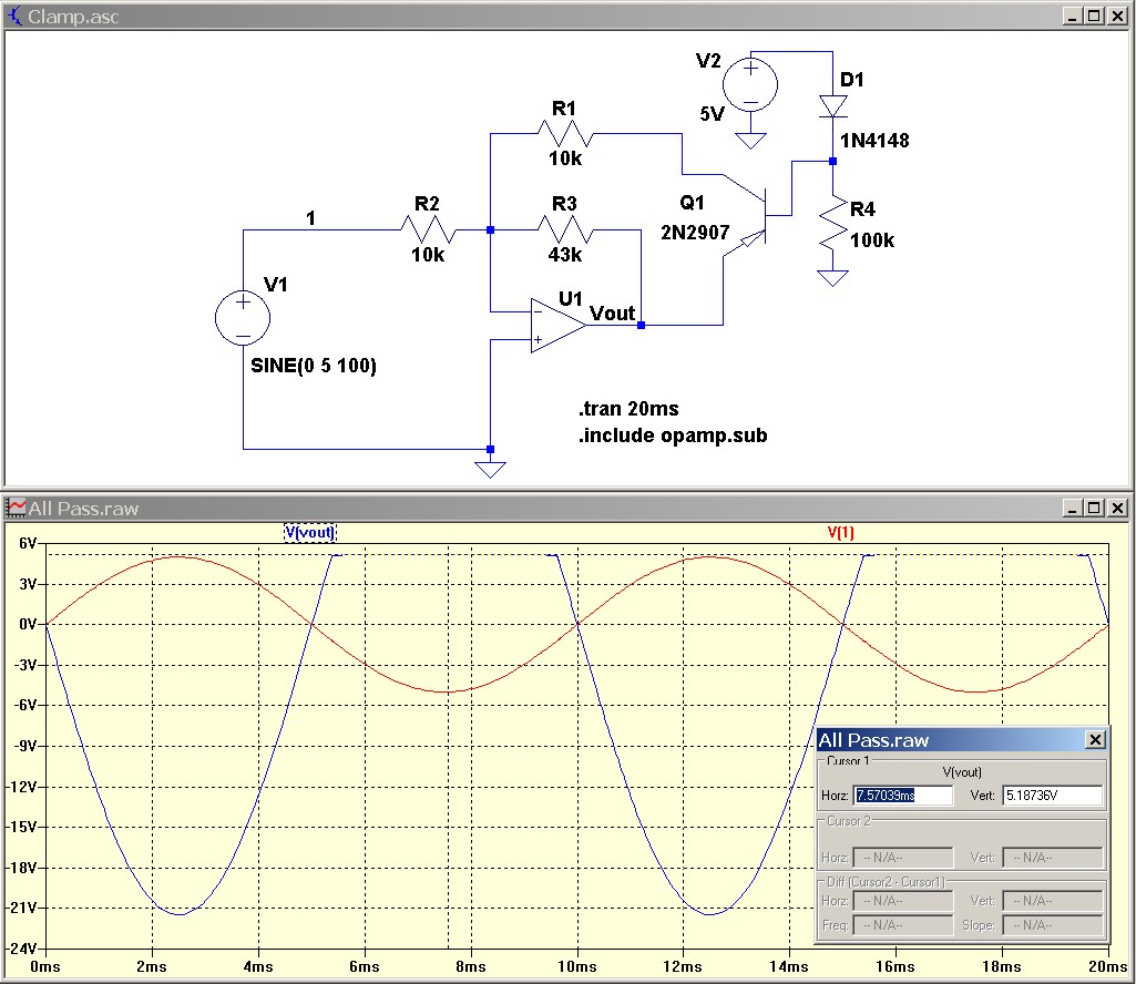

Below is an LTspice simulation of the circuit. Note that you need to add an input resistor for proper operation of the circuit. Notice the sharp clamp point is at 5.19V for V2 (Vref) of +5V.
View attachment Clamp.asc
Edit: An observation: R4 is not really needed and can be replaced with a short.

Strictly speaking though it's not really a clamp, it's a gain limiter. It doesnt clamp the gain, it just reduces the gain when the output gets above a certain level.
The 100k resistor forward biases the base emitter when needed. Without that the transistor would not turn on. With it shorted, it will turn on too soon.

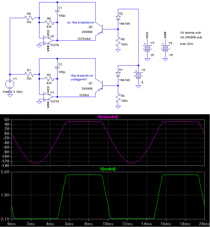

Vbe breakbown is not modeled. When the output swings about 2V below ground (assuming 6V breakdown), there will be nearly a direct short between the op amp output and the reference voltage. Attached is the result of a sim with and without Vbe breakdown. I used a "real" op amp. because opamp.sub does not have output current limiting.
The 100pF caps stopped low-level oscillations.
2N3906.sub has the breakdown modeled. Q2 prefix is QP. Q1 prefix is X.
Below is the subckt that I made. If anyone sees a flaw, or can suggest improvements, please speak up.

Clamping the output doesn't mean clamping the gain, it means limiting (clamping) the output to a fixed level, which this circuit clearly does. At that point the gain becomes essentially zero to any further input voltage excursion.
The 100k resistor is to provide bias current through the diode. If you didn't have the diode then you wouldn't need the resistor. You would just connect the transistor base directly to Vbias.

Mr Al, the transistor never saturates in Carl's simulation, or in mine, so the 10k collector resistor has no effect.
As I pointed out, and everyone is ignoring, the circuit will not work, except at low voltages, because of Vbe breakdown.

My op amp is an ideal device and has no voltage limit. In the real world the voltage would be limited to the supply voltage or less.
MrAl, as Roff noted the 10k resistor (R4 in the original schematic, sorry for the confusion with two R4's) has no significant effect on the clamp. It does not provide variable gain. You can remove the resistor and the clamp will operate just the same. Your thought experiment is in error. Run the simulation if you don't believe.

MrAl, the transistor is active (unsaturated) until about 500uA flows through the 10k collector resistor. When the transistor is active, the 10k resistor has no effect.
With the output at 5V, 116uA (5V/43k) will be flowing through the 43k resistor . This means that the source resistor has to be providing (500uA +116uA)=616uA before the transistor saturates. This would require that the input voltage would have to be more negative than -6.16V in the posted simulations.
