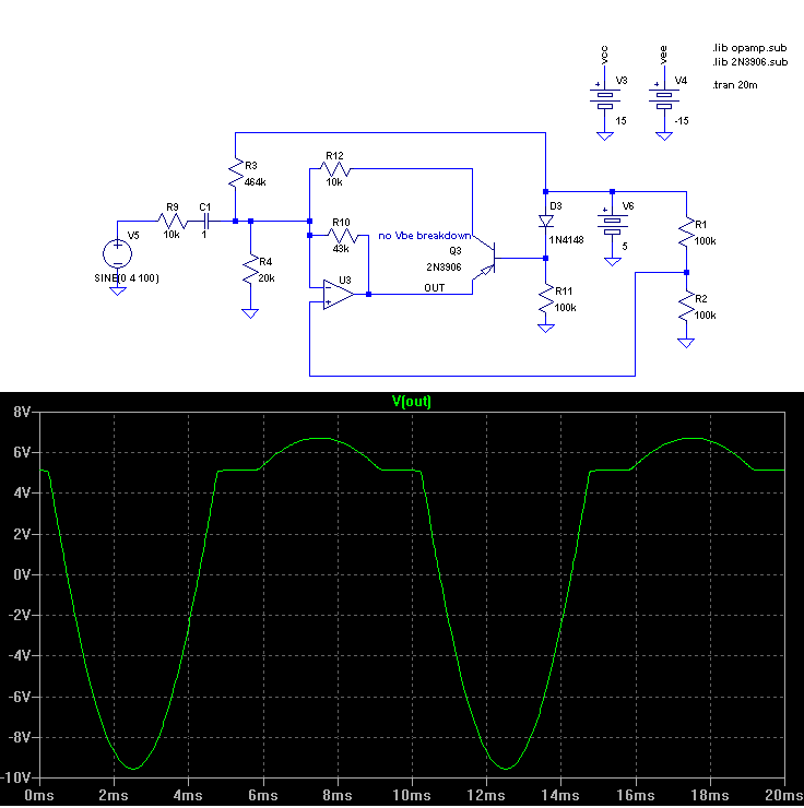

MrAl, the transistor is active (unsaturated) until about 500uA flows through the 10k collector resistor. When the transistor is active, the 10k resistor has no effect.
With the output at 5V, 116uA (5V/43k) will be flowing through the 43k resistor . This means that the source resistor has to be providing (500uA +116uA)=616uA before the transistor saturates. This would require that the input voltage would have to be more negative than -6.16V in the posted simulations.
How can you say that a 10k in parallel with 40k does not have any effect? The input voltage is not set (yet) until we know the true value of the output impedance (or resistor value) of the previous stage.
That's true. My comments were in the context of the simulations that Carl and I posted. However, if the input current is sufficient to saturate the transistor, there will still be "flat spots" in the output where the transistor isn't saturated.
I made some arbitrary assumptions about vref, the source resistance, and the input voltage, but I believe the results will hold in the general sense as those values are changed.

As the transistor starts to conducts it will clamp the output at the Vref value. There is no variable gain at this point and the 10k will not have any effect until the transistor saturates. It's only after the transistor saturates that the value of the resistor value comes into play. Just do the damn simulation and go argue with that.

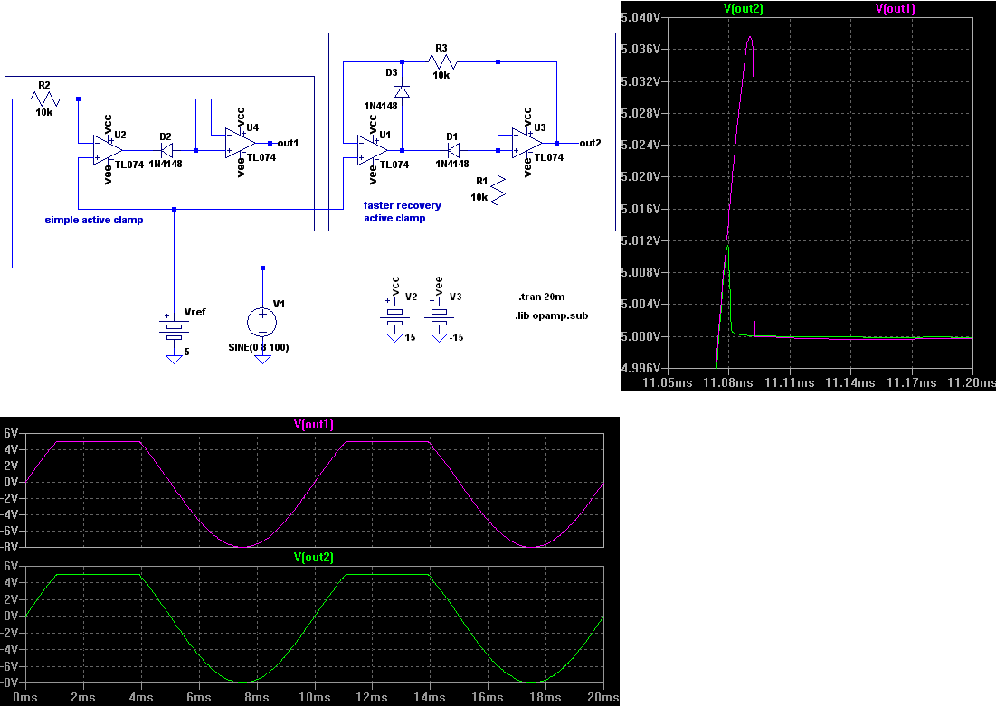

Just to satisfy my curiosity, I designed a couple of precision feedback clamps. I'm posting them here because I thought others might find them useful, or at least interesting.
Response time for the simple clamp is primarily a function of op amp saturation recovery time and slew rate.
Response time for the "improved" clamp is a function of slew rate and GBW product. The op amps don't saturate in this version.

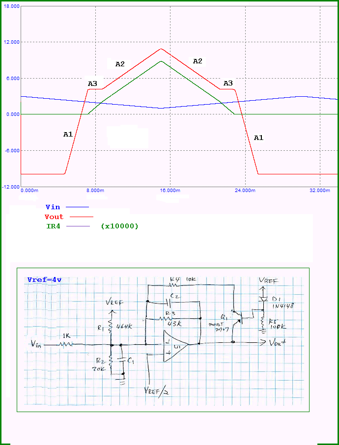

Hello again Carl,
No variable gain you say? Well maybe then you would like to argue with the simulation because after seeing the simulation apparently i dont have to :)
As you can PLAINLY see from the first diagram below, the gain changes, and it changes three times. It starts at one gain A1 and changes to A2 as i predicted. There is a short portion where it is flatter but nonetheless still a gain A3 and not a clamp, although you may wish to call that one tiny section where Vin is just right a "clamp" if you like.
This is exactly why i had suggested it may be a sensor (or transducer) amplifier because it can be used to correct a transducer output curve if it was innately nonlinear.
Convinced yet?

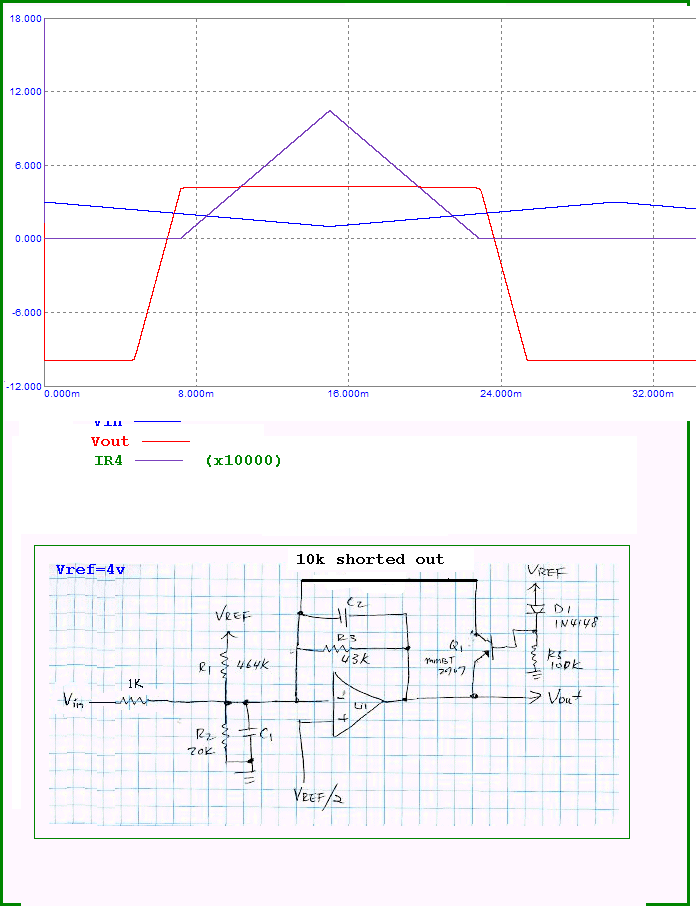

If you still are not, then check out the second drawing that shows the response with the 10k resistor shorted out. It clearly looks more like a clamp circuit now just as i had suggested previously. It's a very different response without the 10k there. This also shows why i suggested removing the 10k resistor if they wanted a better actual clamp circuit.
The difference in our simulations is that I used a 10k input resistor and you used a 1k, which gives 10 times higher gain and a 10 times shorter clamp region. I always stated that the 10k resistor had no effect until the transistor saturates. But between the time the transistor turns on and the transistor saturates, the circuit clamps the output.
So we have no real disagreement as to the operation of the circuit, just one of interpretation.:)
