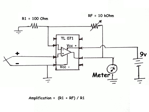

I'm very new at this. Just started playing around with an op amp last week. I have very basic knowledge from a couple courses, but that was also a while ago.
I'm trying to amplify a small voltage (about 0-10mv from a thermocouple). I looked at some schematics & data sheets to try & design my circuit, but somewhere along the way I definitely goofed because I'm getting totally unexpected output values.
The voltage output is about 7.5v with 0v input (grounded), using a 9v source. Am I saturating the Op Amp by trying to amplify the signal too much? What is the max amplification for a typical Op Amp, and what are good resistor values to use for R1 and RF (shown in the attached diagram).
Thanks in advance!

You can't do what I think you want to do using a simple op amp as you have it. You need to first get a handle on CJC (Cold Junction Compensation) when using an op amp. You may want to give this a read.
Another problem is the output of a thermocouple is non-linear across its temperature range.
This is an example of an instrumentation amplifier designed for use with a thermocouple. Note it even provides the CJC I mentioned. There are others but that will do as an example.
What thermocouple type do you have? What is your goal with this? Then maybe we can better help you get going.

The TL071 is not a rail-to-rail type op amp. It can not operate with the input down to the the minus rail. You either need to go to a rail-to-rail type op amp or add a negative power supply to the op amp.
The circuit will work, sort of, if you do what Crutschow suggested. Since the meter - is connected to power ground, the opamp would have to be capable of rail-to-rail output, as well as having an input range all the way to the negative supply. The best way to utilize the TL0xx is to add a second 9V battery, and operate the circuit on +-9V supplies.
A thermometer built this way will not be a precision measurement tool, but you should see a meter deflection somewhat proportional to temperarure above ambient, due to the lack of a cold reference junction. The Meter movement should take less than 10mA for a full-scale deflection (or be a 0-5V voltmeter)
The chip Reloadron suggested is an easy way of doing it. I looked into them, but wanted to try it myself. The thermocouple is a Type k.
I may play around with CJC in future using a thermistor and a PIC, but for now I'm just trying to see if I can get the thing working. I added a negative supply as crutschow suggested (using resistors as a voltage divider) and it works (thanks!) - although my method is very rudimentary, and the op amp's internal resistance seems to be throwing things off a bit.

Mike ML (or anyone) do you have some suggestions for an op amp that is rail to rail, and allows input right down to ground? (Able to amplify the mV input without a negative source?)
I've used the MCP619 before with pretty good success in single supply temperature and pressure sensing circuits.
The LM158/258/358/LM2904 have a common mode input voltage range up to 0.5V below Vss. Their output will pull within mV of Vss, but will only pull to Vdd-1.2V when sourcing current. They are very slow, but for a thermocouple sensor, they would work just fine.

Low offset is important in the specs, like the MCP619 and the opamp you quoted, but you're going to find that the thermocouple effects of resistors/copper/solder can swamp the opamp. Layout is vital for good results. Keeping thermal differences of the input components to as close to zero as possible. Insulation around the input is a good idea.
