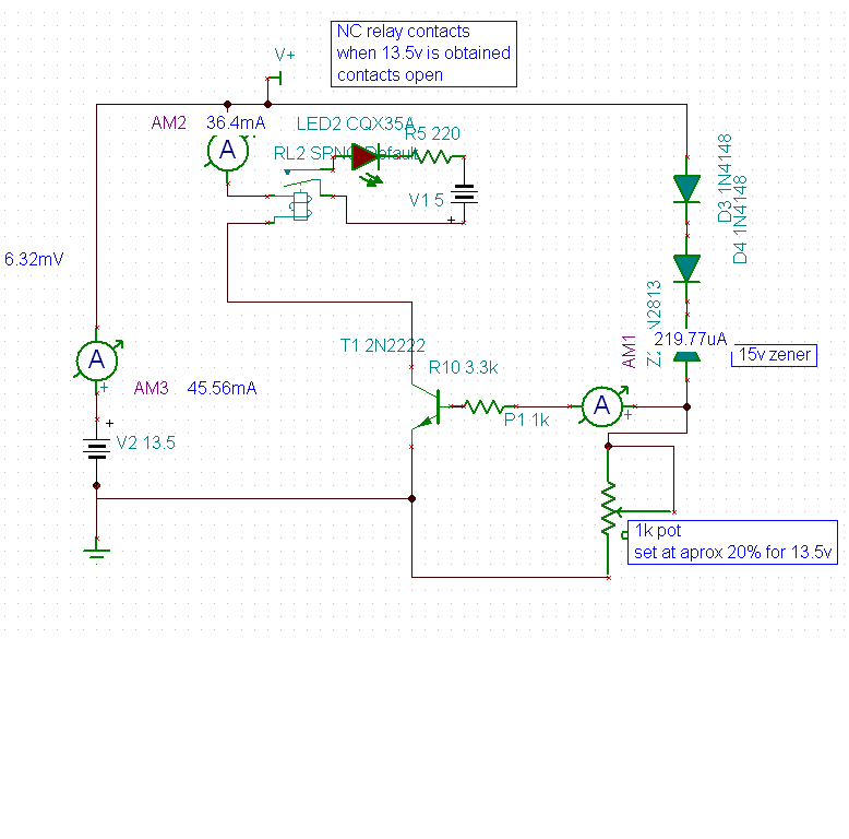

Not quite, two diodes reversed bias with pullup will make And gate.
Hi Mike,
Well Mike, that's your version. Mine uses three
I was going to use a third diode just to make sure the
transistor turns off fully. With two diodes and pullup, there could
still be as much as 0.6v at the base of the transistor. With an
extra diode in series with the transistor base and a light pulldown
on the base, the transistor base sees about 0.15v and turns off
fully. Depending on load it may work anyway, but it could be close
without the extra diode, not something i would be comfortable with.
Another version would put the extra diode in series with the emitter
if power considerations allow.
Still yet another version could use an extra resistor to divide the
diode voltage down so the base sees about 1/2 a diode drop instead
of the whole diode drop.
