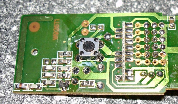

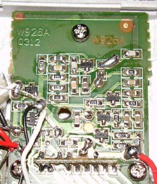

I've got this wireless doorchime with a promised range of 100 meters. But because of my needs, the transmitter will be placed close to the ground (a few cm) and the reciever about 140cm from ground. This give me a range of 26 meters on an open parking lot, and only 16 meters on the lawn.
So, what can I do to increase the range? I think the obvious thing to do is to modify the PCB antenna - am I right?
The transmitter antenna should be as small as possible (10-15cm in size), and the reciever antenna can be a bit larger (30-40cm in size).
Here are 2 high res pictures to study - it shows the PCB antenna and most of the circuits.
I would rather change the reciever antenna, since there are many rules and regulations in my country regarding radio transmissions. I presume this door chime respects those rules since it's a common supermarket product.
I see youve had a bit of fun with the receiver circuit :lol:
What you could do is disconnect the PCB antenna(cut the copper track), and connect it to co-ax so you can have your antenna up higher.
Actually, this was how the reciever looked like when I opened it.
What is a co-ax? I have tried to cut the PCB antenna, and solder a 69cm thin wire to the capacitor, this doesn't give much more range.
Can I somehow increase the sensitivity of the reciever?

Unfortunately You cannot increase the sensitvity of receiver. Most of case (like this also) is a superregenerative type. Need to build a superheterodyne (more complicated) and/or increase the transmitter power. If the TX is wrong position, no or not enough aerial, the higher power not helped.
Co-ax is a type of wire that keeps signals from radiating. Its like what you see coming off of a satellite dish. What you could do is take away the PCB antenna, and solder a co-ax wire to the capacitor. Then on the other end of the co-ax (which is higher in the air) you put an antenna. The higher the antenna the better radiation.
So the co-ax keeps the signal from radiating until it gets to the antenna which would be higher. This would increase range.

If you are talking about the transmitter, there is not enough room to have a large antenna since the transmitter will be mounted on a 1/8 scale RC car.

I was talking about the transmitter.
