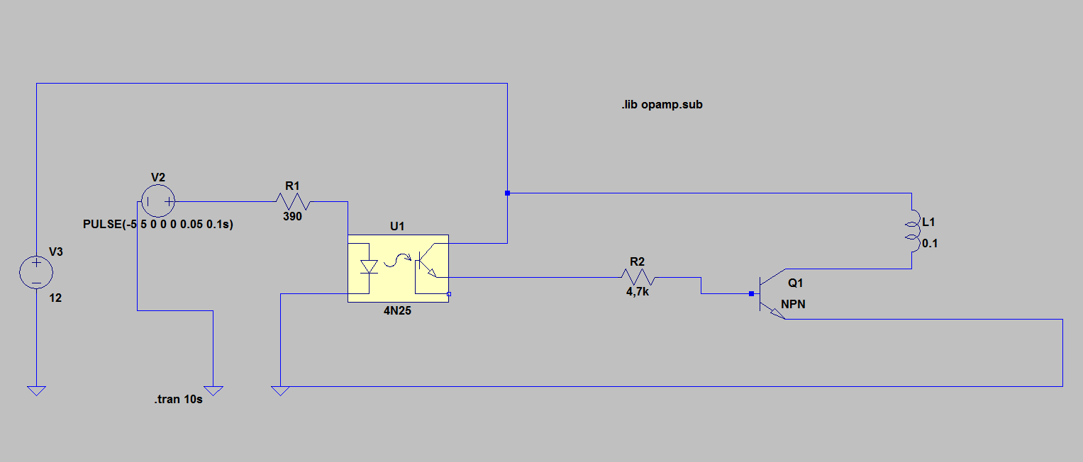

Hey cobra1, thanks for the help so far,
But as you might know, i posted another thread regarding trying to control an ignition coil through the use of a function generator.. And since i wanted to use an opto-isolator, i posted this thread,
And Now Using your example diagram i tried to redesign a circuit, and i was wondering if you could tell me whether or not it can work at all.
The L1/Inductor symbol represents where the transformer would go.
and the transistor i planned on using is the 2n3055,
Thanks for the help so far

Ok Sorry for the lack of an explaination..
simply put, i'm making a circuit to control an ignition driver, through the use of a function generator, where i want to protect the function generator from the high voltage of the transformer.
V2 is used to represent the function generator in the schematic.
V3 is the external supply
L1 is the transformer..

Your circuit needs 2 additional components.
1. A diode across L1 to limit the back EMF otherwise it is likely to destroy the transistor.
2. A resistor from the base to gnd to bypass the Icbo & the Opto dark current.

You mean the base of the transistor 2n3055 or To the base of the transistor in the opto??
The base of the 2N3055 since this base will otherwise have to pass the dark current and its own Icbo
