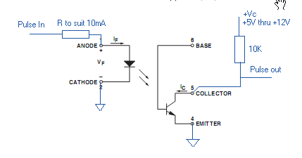

Look at the image for a typical connection.
so I can connect the "pulse out" to my gate driver? I'm guess this basically inverts my PWM signal then, right?
I tried hooking i up like this and it didn't work :(
something tells me it can't sink enough current to drive my 2n2222 and 2n2907 transistors for my gate drive. i guess i just need to order a better optocoupler or better yet one that's made to directly drive a gate?

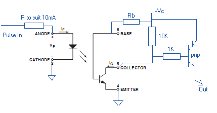

If you need a pullup, add a PNP transistor across the 10K, with a 1K series resistor to the base.OK.?

Look at this image.

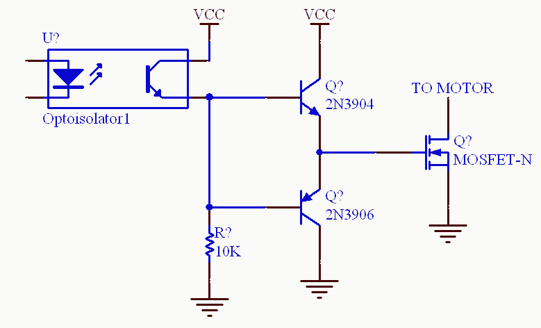

you need to swap the bipolars in the gate drive circuit. You need the PNP up top and the NPN down low. With the way they are connected, neither will ever turn on.

This is more along the lines of what you originally posted: just an opto + transistor buffer to drive the gate, providing current amplification for both charge & discharge. The resistor pulls down the voltage on the bases when the opto is inactive.

Oh i see now he wants to drive a mosfet...that is a different story.
To drive the mosfet properly you need a faster rise signal than an
opto can provide, unless the mosfet can tolerate a bit of extra heating.
The typical way this is done is to drive a logic gate with the opto, such
as a schmitt trigger inverter, then use the output to drive the mosfet
driver.
Another even better way is to get a dedicated mosfet driver chip. These
not only can provide the proper high current gate drive, but can drive
the gate high and low with fast rise and fall times...both a very good idea.
Many mosfet driver IC's already have a schmitt trigger built in too.
