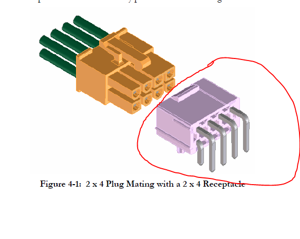

PCIE 8 pin header part number?
This is what I got back:
Andrew, Rosenberger only makes R F Coaxial connectors and cable assemblies.
We do not make power connectors.
Sorry we cannot be of service.
Which is what I expected; hmm - maybe I will forward that on to PCI-SIG and see what they say...
I forwarded the response to PCI-SIG; I also just sent an email to Molex via their contact/feedback form asking for information; I guess we'll see what happens...
Heres' the response I just got from Molex:
Unfortunately Molex currently does not offer the 8 pin PCIe connector that matches the polarization with the picture you provided. The closest part we have is part number 0455870002 which you have already found. That connector mates with part number 0455860002.
As for where PC power supply manufacturers get there PCIe connectors from, it depends on the manufacturer.
Damn - we're back at square one! I honestly don't understand this.

Sorry Ron, might be me, usually is - I "ASSuMEd" we where talking about a "PCB header" not the plug.
One of these...
Cameron, I think we were, the male connector which would mate with the connector on the PSU. The extension connectors work well for this for those who do not want to hack the connectors off the wires extending from the PSU. Anyway, either way there are plenty to be had and your links may help someone else. Sure as heck can't hurt adding them.
Ron
This is a most illuminating thread. I have spent hours trying to find a part number and manufacturer for the connector (the orange bit from Cameron's image).
It seems that it is still a problem sourcing these parts. While sure you can now get them on ebay readily, they will still cost you 3-4 times more than any of the other connectors, which is rather annoying. Also, I see that many Chinese parts go around this by using two non-rectangular shapes as the 2 pin attachment.
119535
Molex still does not make them, and sites like digi-key.com still don't sell them. What's more interesting, Molex does not even seem to make the proper 2 pin attachment that you could use with the regular 6pin PCIE that they do make (The 2 pin that they do make won't fit into a PCIE housing)
I find all this extremely baffling and rather disappointing.
Edit: DigiKey confirmed they do not sell either 8pin PCIE or the 2 pin extension.
