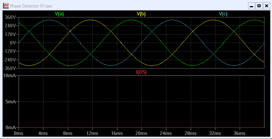

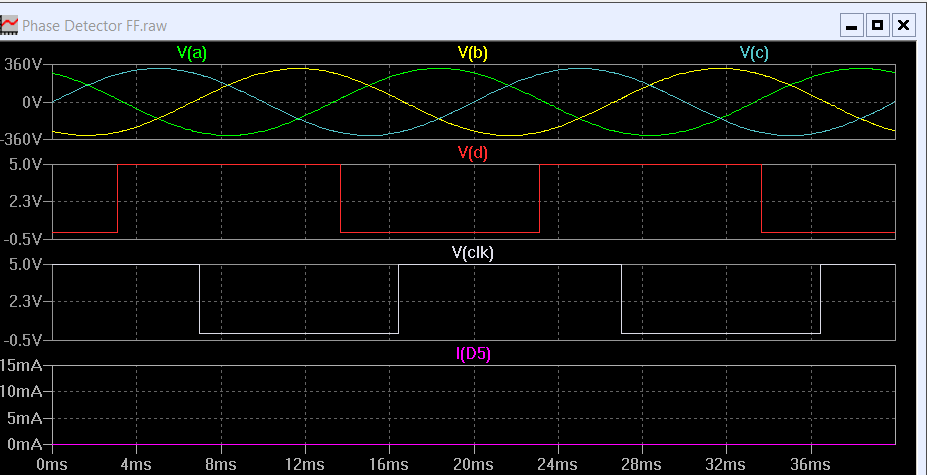

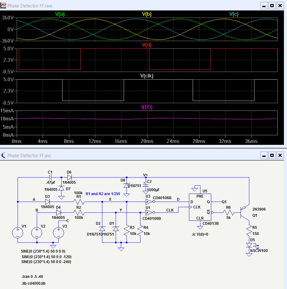

I couldn't get that circuit to work properly either, so I came up with my own take, using a D-FF as shown in the LTspice simulation below.
I added Schmidt triggers at the FF inputs to square-up the signal and avoid any false triggering.
You just need one FF to monitor two phases since there are only two possible phase sequences and those can be detected by just looking at two of the three phases.
I added a 5V line-powered supply to power the circuits. It uses the series capacitor C1 to limit the current to the regulator zener diode D8 without the high power dissipation that a resistor would have.
In the first simulation the phase sequence is a correct ABC. This generates a FF-D input high when the clock (CLK) goes high, so the FF Q output also goes high, turning on the LED (ID5) from the /Q output.
In the bottom simulation graph the phase sequence is reversed (CBA), giving a FF-D low input when the clock goes high. Thus the FF Q output is low (/Q output high) and the LED is off.
Note that the 5V power and ground must be connected to the ICs, which is not shown.
Also be sure and tie all unused inputs on both ICs to common to avoid anomalous behavior.

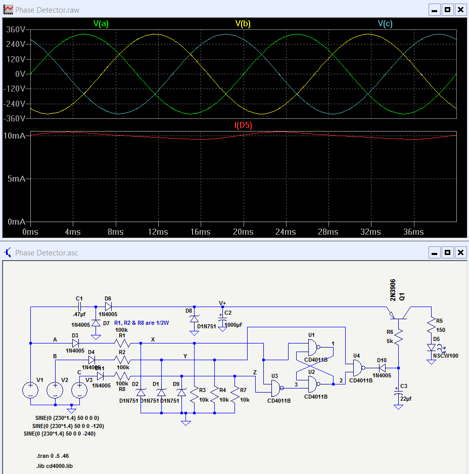

I simulated the circuit shown by the OP. It works perfectly,
and it will even detect a phase loss.
With the sequence ABCABC..... where A is the top phase and C the bottom one, the output of the last NAND is a negative going, 60 electrical-degrees-wide pulse.
With the sequence ACBACB...........the NAND output is always high.
Likewise when you lose any phase, the NAND output is always high.
With the PNP transistor and LED connected as shown, a good sequence will dimly light the LED, and be dark with all other conditions.
If one desires a brighter LED, a retriggerable monostable could be used.

That was my observation also. It didn't keep the LED lit steadily so I considered that not acceptable.
But you brought a good point about stretching the pulse with a monostable.
Below is the circuit using an RC pulse stretcher with an added diode and capacitor at the NAND gate output, if you want a circuit that will also monitor for a phase loss.
The first plot is for the correct ABC phase sequence which gives a 10mA steady current through the LED (with a slight ripple due to the power supply ripple which will not be visible).
The second plot is for the incorrect CBA phase sequence which give zero current through the LED.
