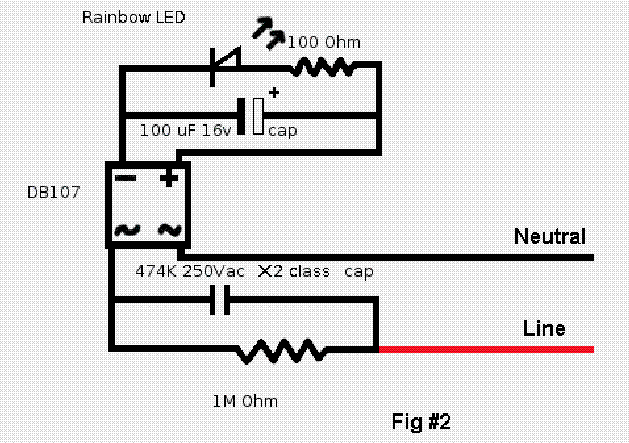

This is a good time to repeat from on1aag's schematic a few easily overlooked details: The mylar capacitor should be X2 class (self healing) and the 1M resistor should be rated for 200V or more. The series 10R resistor is a good idea to limit surges, and it should be flameproof.
As for how many LEDs will work from the same circuit, quite a few, at least a dozen. The LEDs should be in SERIES. The circuit is current regulated.

Hi Kevin,
The circuit diagram is a little different.
kevin-gif.13214
As for how many leds you can connect, start with eight or ten.

on1aag said:
Hi Kevin,
You better change the circuit a little bit, otherwise the 100 µF / 16 V
capacitor will produce a hissing sound followed by a loud bang. :D
on1aag.
hi on1aag,
I felt that 100uF cap was in the wrong place and should be across the 100R and LED,
Kevin assures me he has traced the pcb track and it like his drawing.
I was going to ask him to post a picture of the track side of the pcb.
Can you please do that Kevin???

Hi Kevin,
The 100uF cap is across the +/- terminals of the FWB, as I would expect, refer on1aag drawing. Fig #2
EDIT: Never connect the mains supply without the 100R and LED in circuit!!!

on1aag said:
As for how many leds you can connect, start with eight or ten..
The maximum number of LEDs you can connect depends on their forward voltage, the maximum voltage rating of the 100:mu:F capacitor and the mains voltage (which won't make much difference unless you're want to connect over 10 LEDs).
In this case the capacitor is rated for 16V.
The rainbow LED probably has a maximum forward voltage of maybe 3.5V, therefore the maximum number of LEDs you can connect is 4, if you want more LEDs then use a higher voltage capacitor.
