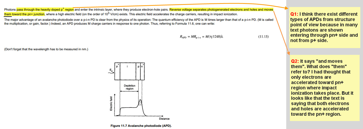

Hi
Could you please help me with these queries? This is the copy of reference I have used. Thanks.
Regards
PG

Try reading the following part of that text:
"Reverse voltage separates photogenerated electrons and holes and moves them toward the pn junction..."
like this intead:
"Reverse voltage separates photogenerated electrons from the holes and moves them toward the pn junction..."
In other words, the charge carriers get separated in the larger area and move away from each other, so only one type of charge carrier gets moved toward the pn junction.
I'm not an expert on this but that's the way i read it.
