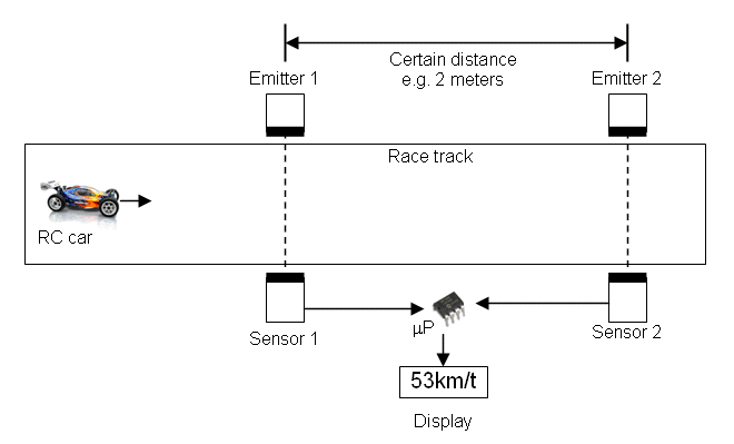

I want to build a sensor, that detects the presense of a RC controlled car in motion, to determine the speed of the car. There will be 2 sensors with a certain distance, providing a PIC with a wired signal, telling the car has passed - the PIC will then calculate the speed from the time between signals from the sensors and the distance between the sensors.

I'm thinking of 2 ways to build my setup:
1. A proximity detector type, that detects a nearby object (the RC car) where the emitter and detector are placed side-by-side.
2. A burglar alarm type, that detects the absense of the infrared beam i.e. when the car "breaks" the beam - the emitter will have to be placed 2-3 meters from the detector since the RC car will be passing with 50-60mph and the driver should be able to avoid the circuits. The emitter should then have it's own battery supply.
I like no. 1 the most, since it's the easiest setup in the field where the measurement will take place. But I don't know what the range of this could be - it should be at least 1 meter (again, the drivers skills should be comsidered).

Perhaps I should illustrate my idea:

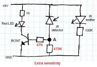

I don't want to spam my own topic, but I played around with the IR emitter and IR detector (photodiode) yesterday, and I came up with the attached circuit.
The red LED is on when the emitter is close enough to the detector. At 5mm distance the voltage at A is around 0.75V - just enough to drive the transistor. At slightly greater distance (2cm) the voltage is lowered to around 0.27V and the red LED is off.
If I disconnect the emitter, then the voltage at A will be 0V.
I guess I need a comparator to sense lower voltages than the 0.75V.

Hi Futterama,
Your circuit uses an extremely low value for the transistor's base resistor. With the 7mA load and a minimum current gain of 100 in the transistor, a 47k resistor would allow it to turn on with about a 5V input.
Your circuit also uses an extremely low value for the photodiode's load resistor. If it is 470k then almost all its current would turn on the transistor.
Then your circuit would be 100 times more sensitive, but much slower if it matters. It will be less than 100 times the range unless you focus the IR beam.
You are pumping a whopping 77mA into your IR emitter. Is it operating within its max continuous current rating? Usually IR emitters are pulsed to remain cool. :lol:

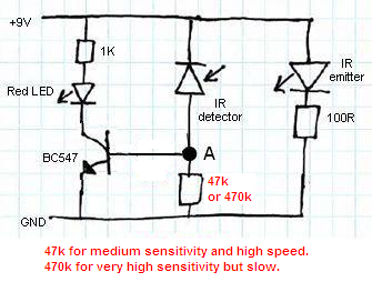

audioguru said:
Hi Futterama,
Scrooge, why would you need a base current limiting resistor (the 47k)? The photodiode is a light-dependent current source. Even if that resistor is zero ohms, the photodiode will never generate enough current to zap the transistor. The only reason I can see is to protect the transistor if the photodiode becomes shorted.
Hi Ron,
Good point! :lol:
Without the base resistor then the transistor will receive the full current of the phototransistor, plus since the phototransistor will have a higher reverse voltage aross it, its capacitance will be lower and therefore it will respond quicker.

The emitter diode is supposed to handle 100mA.
I'll give your suggestions a try, lower the transistor base resistor to eg. 10ohm and raise the other resistor to eg. 470ohm.
Thanks for your comments :)

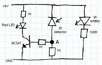

Hi Futterama,
We were talking about making it like this:

audioguru: I have testet the new circuit with the 470kohm resistor and no base resistor to the transistor.
The circuit is very sensitive to daylight but not really sensitive to the IR diodes (I actually have 3 in series consuming 42mA).
I don't get it...
