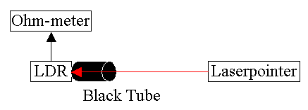

awright: Thanks for the long and detailed explanation.
I have thought of using a laserpointer, but it will be very hard to point it directly at something the size of a photodiode. If I use a laserpointer, I could perhaps use a LDR as the detector and just put it in a dark 10-20cm tube.
The cheapest laserpointer I can get my hands on is a 650nm 1mW and costs around $15.
I have a laserpointer already though, so I can test it with a LDR and tube in sunny weather (lucky it's summer in my country now).
Edit: The 455 kHz is from the table of stored components at my work where I got the photodiodes and emitter diodes.
I've made a quick setup as shown below.
With the "sun in the detectors back" this would work.
With ambient light (sunshine from behind), the resistance in the LDR was around 5kohm, and when pointing the laserpointer directly at the LDR from a 2meter distance, the resistance in the LDR was around 200ohm.
I just have to make a stand for the laserpointer to keep it very steady and point it at the LDR in the tube. The LDR + tube should be adjustable in position, perhaps with some precision adjustment to adjust it in millimeters to make the laserpointer hit the LDR right.
What I hoped I could archieve with IR, was to eliminate the need for precision adjustment of the emitter and detector, but it seems to be very hard to get IR working right in the sun.

The trick is to modulate the IR, usually at around 38KHz, and use an IR receiver IC to receive it. This minimises the interference from the sun, as it's AC coupled, so a constant high brightness isn't much of a problem, it's the changes which it amplifies and detects, not the ambient level. Bright sunlight does reduce sensitivity slightly, but it should work well enough, and it's VERY easy to do.
