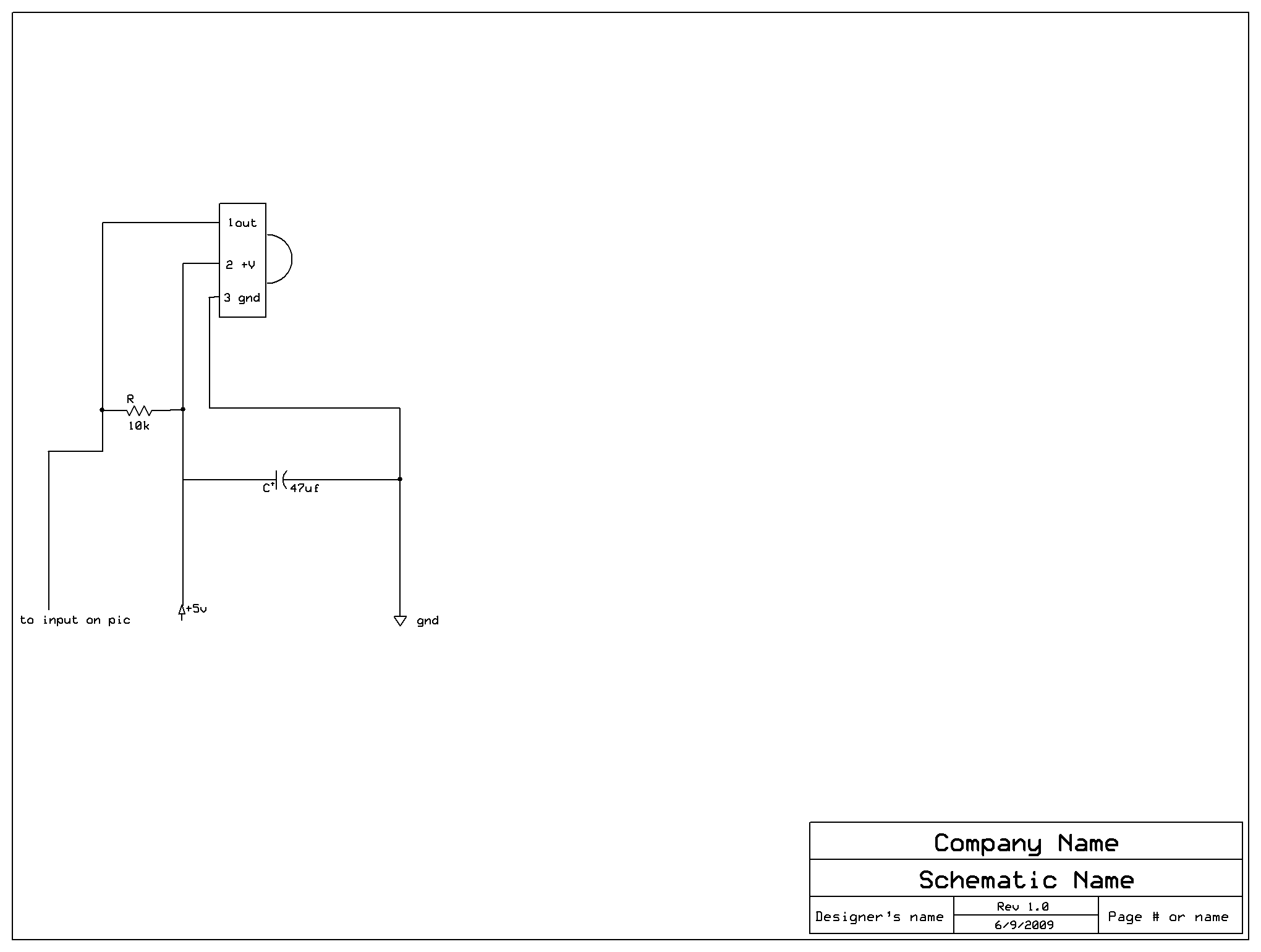

My ir sensor only outputs 1.7 volts(5 volts)...I built it according to goodwin and others tutorials but it does'nt seems to work...What error could it be?
There is no current output on ir receiving.
Is it a common error?

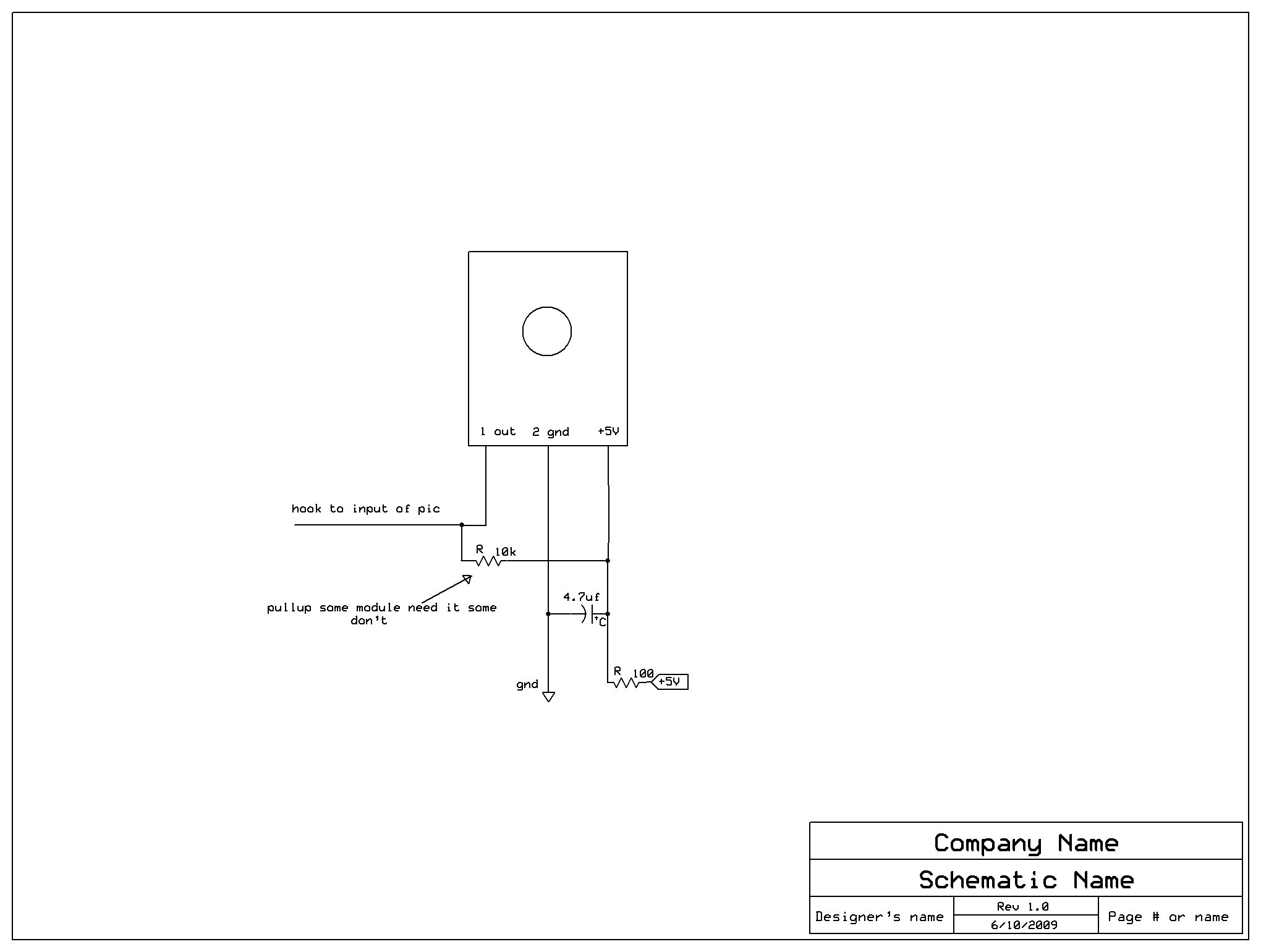

All ir module don't work the same. Some have to have a pullup resistor some don't need
it. The best thing to do is get the module working first then hook it to your pic you can hook a led from the output with a resistor 1k to - volts and see if it's working Some modules you have to hook up like this.
be80be's diagram misses out the supply decoupling resistor, this is pretty crucial,, and it may not work without it.
You need to be aware as well that not all modules have the same pin connections, so you need to make sure it's connected the right way round.
I have never used a decoupling resistor the modules I use never would work wired like that I found this a long time ago **broken link removed** And it works for me. But maybe I should of said not wired the same to
Only thing is I use a 10k and 4.7uf I think in my drawling I marked the cap a 47uf it should be 4.7uf

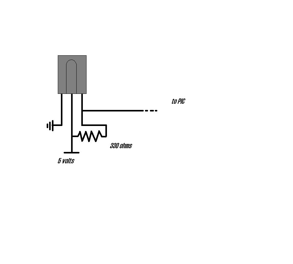

Hey, i just made my two PIC's talk together with a phone:)!
(with ir transmission,TSOP)
After scratching my head i tought: why dont use this design?
It works very great, and that cant be due to any programming error, because there are no wire connecting the two microcontrollers, only air!
After testing, none of the parts where hot :rolleyes: ... so it looks alright, can someone tell me?

Done that, its progress.
