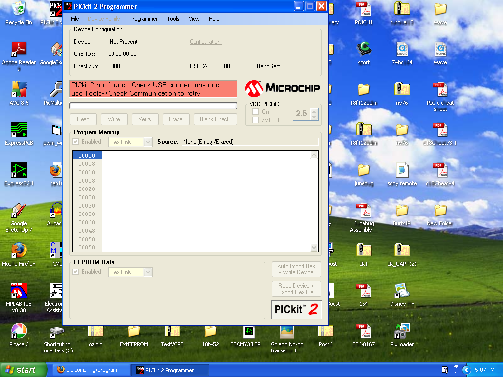

My pickit2 got short circuited...is there a way to repair it?Please help me, i am really sad...

What is or is not you pickit2 doing? Why do you think it is broken ?
What's it doing It is almost impossible to short a pickit2 it will not turn on. If you hooked it up to something that has a short in it it will not power up
Just hook the pickit2 up by itself and start the pickit2 program let it come on and then tell what it show you word for word not in you words Ok. Even better if you can screen shoot it like this.

This is what you get if you hook it with + to gnd and - to vdd just change the wires right and it comes on

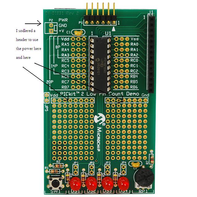

My usb port is burned! Very luckily, i have one spare, but still, i am afraid of using it anymore.
I put duct tape on the voltage supply(ducttape doesn't conduct, i verified).
Is there any other way of shortcircuiting?I really want to avoid that, or my father says he will have to take appart the computer main pcb to repair or something like that(big troubles).
(I still prefer that my pickit2 is not broken, even if the port is a 2.0 from a fireware one, pretty hard to find my father said)
EDIT: I used the started kit, the vdd and vss and very very close.

Look at that, the top left.

That's hard to believe you burned out the usb port. I've shut down the usb power before powering a stepper with my pickit2 I put headers on the low count board to use the power and power the pic on the low count board after that . I rebooted my computer and the usb came back on. But my computer tells you if you have to much load on the usb. You need to get a powered hub with a wall wart hooked to it.Something like this one Adesso 4-Port Powered Hub Mini Hub - USB THe hub has
. Bus fault detection will automatically reset device. The hub supports bus-powered and self-powered mode.
