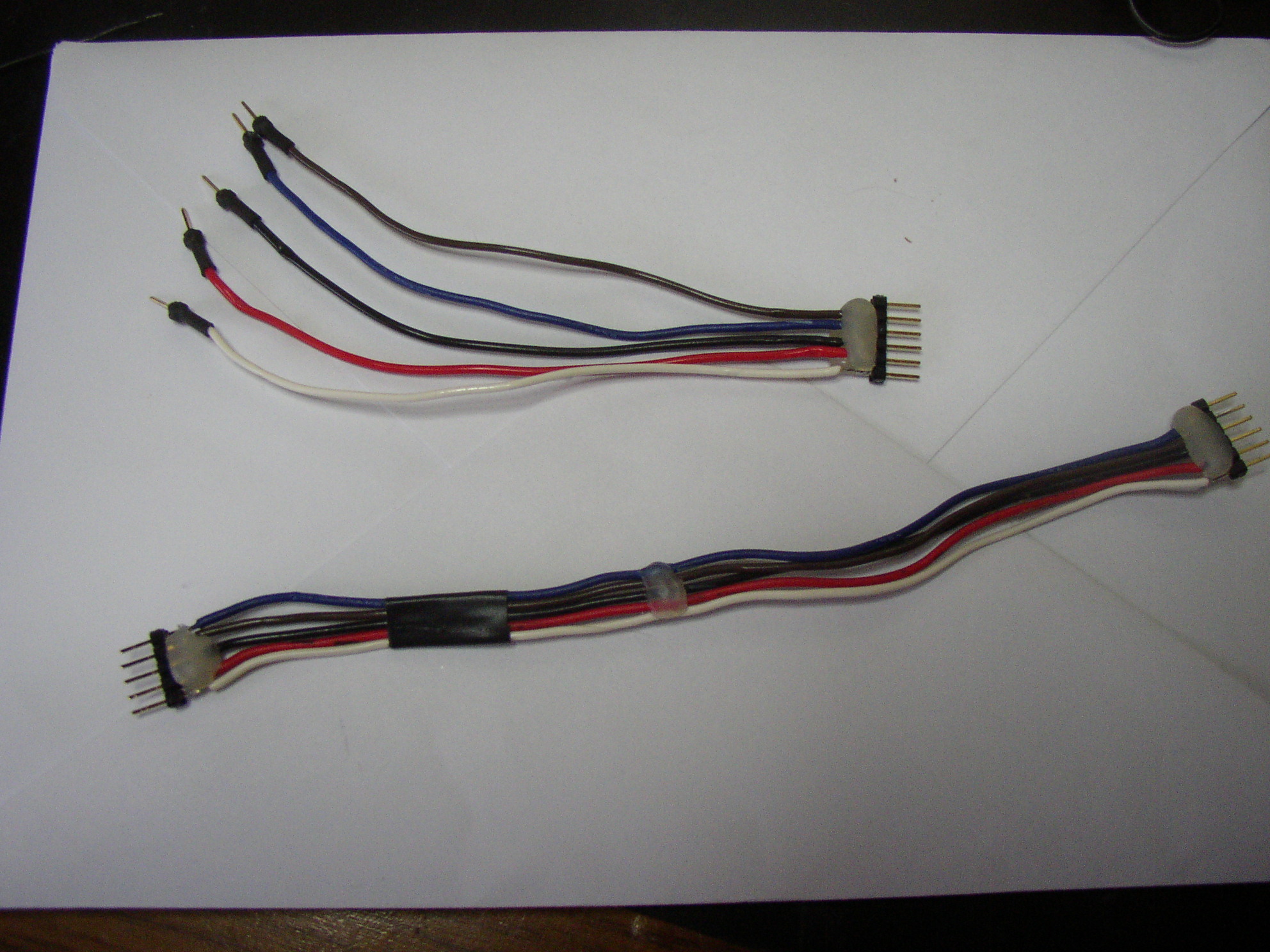

Here are my connectors for use with PK2, connects programmer to target device on breadboard.
Actually, I find the one with individual wires to be handiest.
And here's mine:
Here's some closeups of the connectors:
My breadboard ICSP adapter, built from a 2x5 shrouded IDC male connector soldered to 2x5 pins of two-row header. This is the best way I've ever done it. I have a bunch of these. They're rock solid on the breadboard. You could swing the breadboard around your head by the cable and still have good connection. They cost less than 50 cents to make:
Barrel effect in this tight macro photo makes it look like the wires are in the wrong places, but they're actually not.
Also, you can take advantage of Microchip's liberal sample program.

My cable is pretty much like yours Futz.. I don't know where the ICSP cable length thing comes from, but mine is approx 30cm, and works fine..
