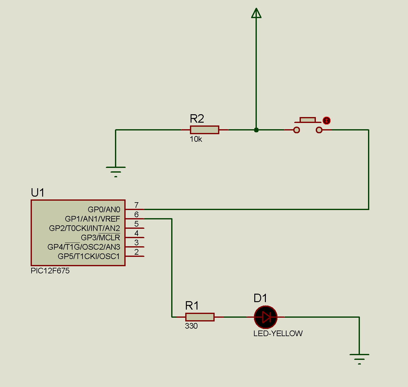

I download a proteus 7.5 .DSN file for a 12F675 Timer. It has one input switch and one LED in the output. I already have the hex code. Not the source code..
My hex file is works like:-
1. Power on the System the LED will ON.
2. When press the switch, LED will OFF.
3. If switch is pressed, The LED will OFF
4. If the switch is relese, The LED will ON for 5 Seconds and turn OFF.
In my needs, only change in the first state. ie, Power on the System the LED will be OFF.
any help would be appriciated.... Thank you so much

What pin is the LED on? Which pin is the switch? (cannot read the .DSN file) Not that I can help, but anyone looking at the hex code, and dis-assembling it, needs to look at which pin is being set to turn on the LED on power on...
This is the schematics extracted from the zip file.
I disassembled the hex file and it was confirmed the source was not written in ASM. It uses timer 1 for the delay and 7 bytes for scratch vars from 0x20 to 0x26.
So I think the best is to follow Max advice and write a new program in C or BAS for the job.

Its compaile and working same as like the first hex I Supplied. I need to OFF the LED when the circuit power ON.
Thank you so much for the asm file...
Done...
This is the original code..
MOVWF GPIO ; !!Bank!! GPIO - TRISIO
CLRF ADCON0 ; !!Bank!! ADCON0 - ANSEL
MOVLW 0x02 ; b'00000010' d'002'
and I change the code like this...
MOVLW 0x00 ; b'00000000' d'000'
Now its working fine what my needs...... Thank you so much everyone... Especially Allen...

A) That circuit is wrong!!! The button isn't biased one way or the other... the resistor should connect to the pin!!

Yes Boss.. The resistor connection is wrong. But I change the conection.
