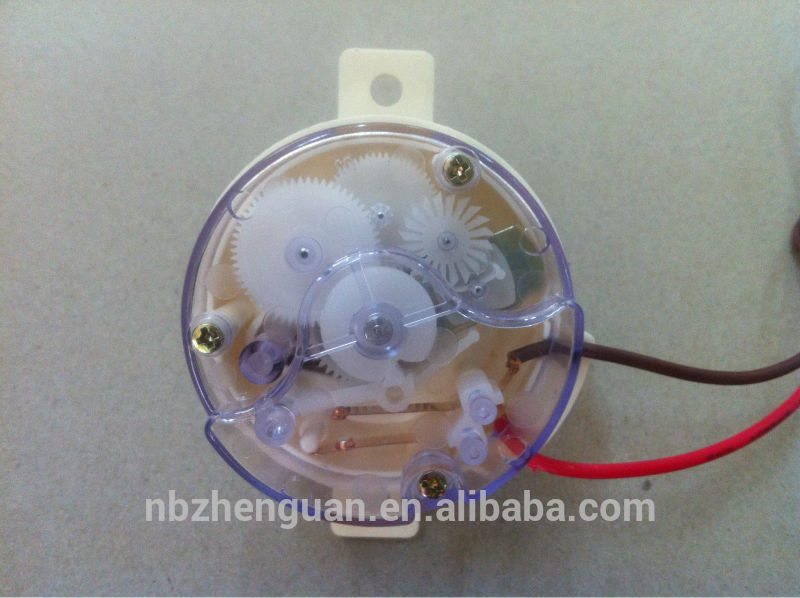

I have this timer and It can be used as kitchen timer. It need to a good switching and Buzzer. I try to make one with 12F675. Its so simple in mecanical side...more complicated in software side (for me)....
