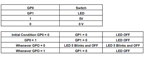

Ohhh... Allen, Just take a look these..
Its going to more complicate...ohh... its working 60%.....
I try to understand to you, what I really needs..
njbcBQ
Allen,
https://ibb.co/njbcBQ
this is actually I want....
Reguards Manoj

Allen, the last statement is not working..
whenever GPo=1 then GP1=0
this statement is not working...
will contact you latter
reguards
Allen,
Initial condition is also not done...
Initial condition is LED OFF.. But you last code, It is blinking the LED when POWER ON the system.
Reguards Manoj Soorya
