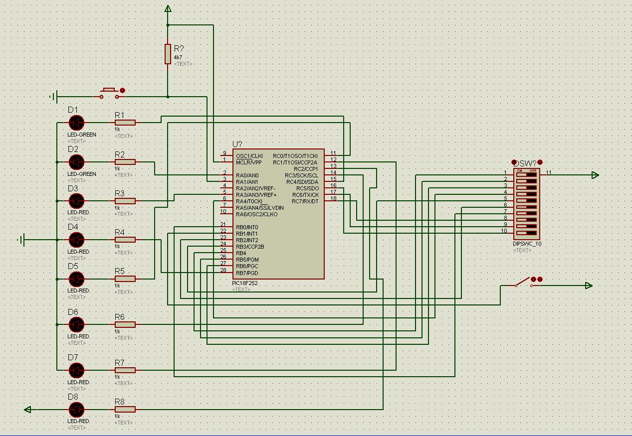

I have problem with programming .Code is in mikroBasic Pro see attachment.Its program with logicall function.In proteus work hex good but when i burn hex to pic18F252 and get them to pcb ,pic not working.On the start must be two leds switch on.But nothing.On pin 1 is 5V and other supply are OK.In Proteus is OK.When I burn pic LVP is disabled.

are you using internal rc oscillator or external crystal? about 90% of problems are with config bits and clock .
refer to the data sheet for config bits.
yeah, mikro C generate hex files which has no config bits. which programmer do you use? is its pickit?
how do you program the pic? which programmer are you using? is it the programmer that comes with mikro basic?

proteus and real world simulation are entirely different.there is no need to use the resistor network in case of proteus, the data is already therein the properties window. so in real worldapplication,,, if you use the rc oscillator for clock please refer page # page 18 of https://www.electro-tech-online.com/custompdfs/2011/09/39564c.pdf. the oscillator frequency must be supplied to the MCU for its normal functioning. generally we use HS and LP modes. in your application RC is enough, so refer page 18 of the above said pdf. read from page # 197 for further congig bits types and how to enable that. generally we disable all of the bits and enable only the code protect bit ;) happy burning!!
