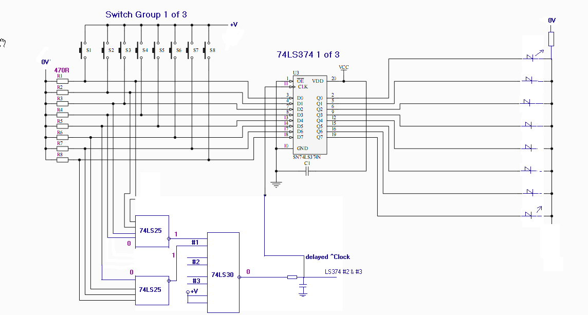

hi mocucz,
This has been modified to give a high on only one pin at a time.
Check it thru.:)

Hi, ericgibbs,
Thanks again. :) So here's your idea: Control.pdf.
First: I couldn't find 74LS25 so I changed it with SN74HC4002 (again dual
4-input positive NOR gate).
Second: At the triggers' outputs you see "Port#". I'm placing a buffer
(SN74LS541N - Octal Buffer and Line Driver with 3-State Outputs) on each
of the outputs. So that I can send positive impulses to as many switches
as I want. In my case: the greates amount is 4 (MAX333). On each of
the switch inputs there's a pull-down resistor tied to GND.
What's you opinion?

One small point, you have the switch resistors to +5V, should be 0V.
I'll look at the MAX333 input loading, it looks as a the LS374 should drive the MAX [4] directly without a LS541.

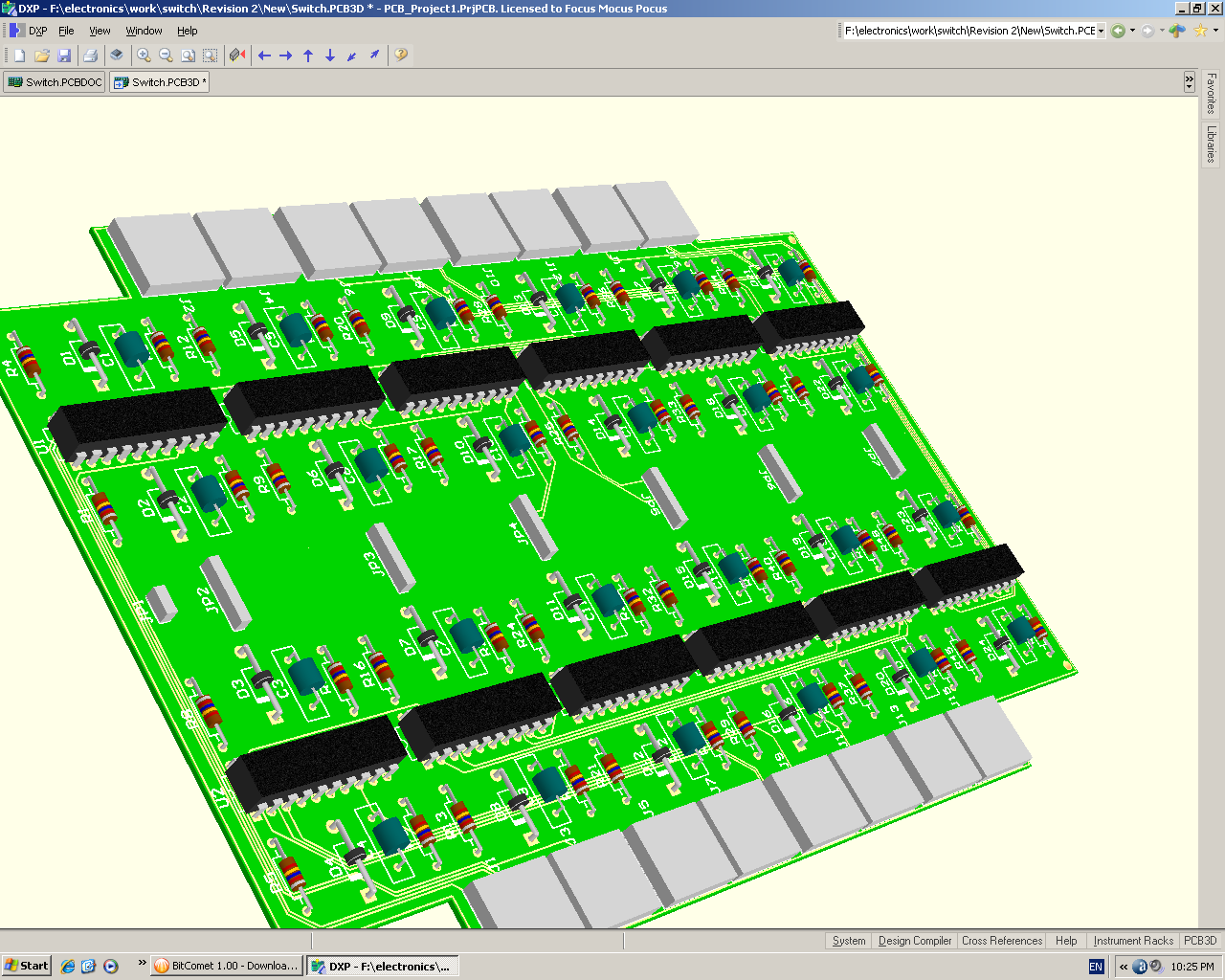

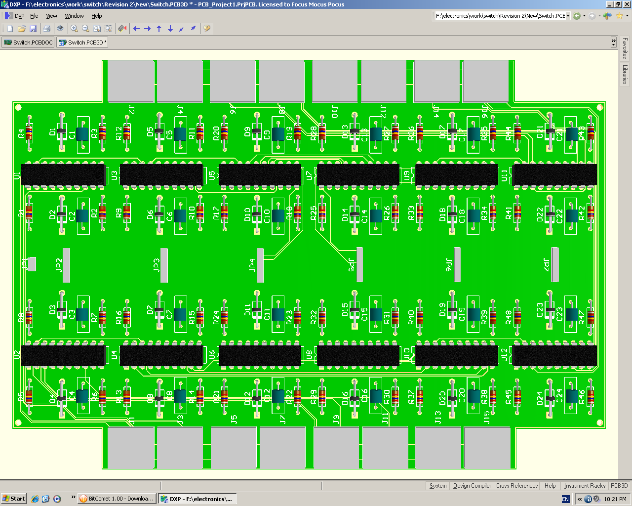

I am done with the first (switch) board. :)
Now I'll do a little break and after a day or two I'm starting the second board (control). :)

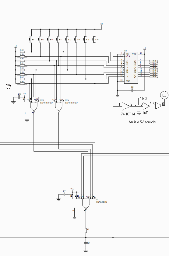

Hi, ericgibbs, :)
While we were discussing the control unit I missed telling you (my bad again)
that I might (and certainly will) need a "RESET" button. I didn't mention that
part, did I. The idea is whenever pressed this button will set the switch
in "straight-trough" mode where every input port responds to its output one.
The other tiny detail I didn't metion too is the buzzer. When pressing a
button a short beep is produced. Just as some kind of (sound) indication.
Here's the switch board :) :

This addition will give a bleep while a button is pressed, the bzr is the type that sounds when 5V is applied.
I dont understand the RESET requirement, can you explain a little more.?

So ... you the switch does 1->1, 2->2, 3->3, 4->4. The you decide you another
pattern and you press for example S4: 1-3, 3-1, 4->2, 2->4. After a while you decide
you another pattern and so on. After you've done a few patterns you decide that you
need to go back at the start condition where 1->1, 2->2, 3->3, 4->4. And right there
you press the RESET button which sets all the switches on the big PCB in there normal
state so that you can come with the 1->1, 2->2, 3->3, 4->4 mode.
I hope I was useful. If not, I'll try explain it better. :)
Any cometary on the board? One thing you can say at first sight: It's HUGE! :)
You do realise that only one output will be set at any one time, there will be no pattern.?
Example: If I press switch #1 of group #1 this will ONLY set output #1 of 74LS374 High, ALL the other outputs will be Low.
If I now press Sw #3 of group #3, ONLY output #3 of group #3 will go High, ALL other outputs will go Low.
This will happen because the three LS374 are clocked from a common clock.
If you want to control each LS374 separately, you must have individual clocks for each LS374.
Is that what you are expecting.?
OK. :) Once again:
When I press S1 an impulse come out at the other side. I take that impulse and send it
to the inputs of a buffer. At the outputs of the buffer I have that same impulse eight
times. Eight equal impulses.
With these same eight outputs I go to every single switch I want to "power on".
And that's how I have "patterns". And that's how a single button does a certain pattern.
Sorry about the stupid question, but I just want to be sure I understand what
you've drawn. So SN74HCT14N is a Hex-Schmitt-Trigger Inverter right?
The other thing is a diode, may be. But I am not sure because I can't
see it right. But I think you've placed a diode (1N4007 for example)
right between pin 2 and pin 3; anode goes to 2, cathode goes to 3?

Its a signal diode, 1N914 or 1N4148.
It is a hex schmitt invertor.
