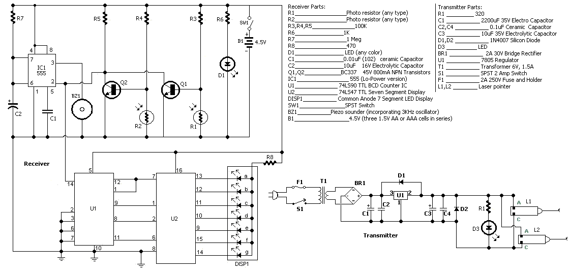

Here it is
I tried to search for CD4026 IC but too bad I couldn't find it
need your comments
What is the transmitter part? how does it relate the the rest?
Resistor R8 is wrong. The brightness of the display will change depending upon how many segments are lit.
Replace it with a short circuit and insert a 470 Ohm in series with each segment.
You also will need to insert 100 nF bypass capacitors. One between pins 5 & 10 of U1 and one between pins 1 & 4 of the 555.
Also, you are powering the 74LS ICs from the 4.5 Volt battery.
The manufacturers of 74LS series recommend that the supply voltge should be between 4.75 and 5.25 Volt. So your circuit will probably work when the battery is fresh, but it may become marginal as the battery ages. Why don't you supply it from the 5 Volt supply?

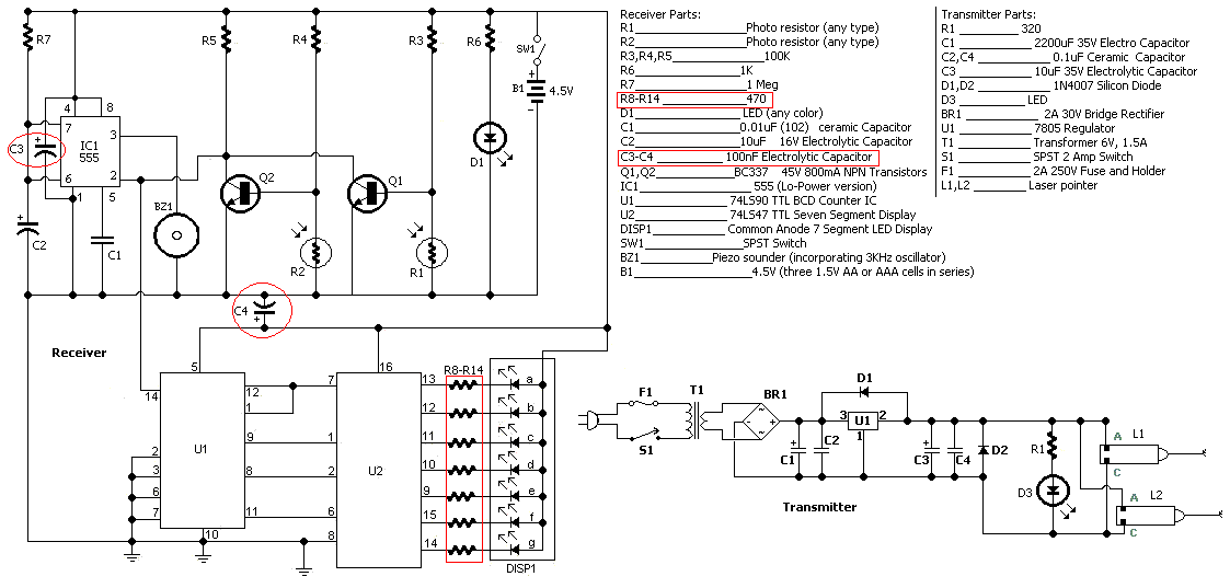

I done what you said
please check and tell me if I done it right or wrong
the trasmitter will be 5 volt power supply with 2 laser pointers
about why I didn't want to use power supply with 5V in receiver is because the shap of the final device will not be near to the main supply
The minimum supply voltage for an ordinary 555 is 4.5V. Your three alkaline battery cells start at 4.5V but quickly drop to 3.6V then the voltage drops slower down to 3.0V.
Your old TTL logic ICs need a regulated 5.0v supply to work properly.
Most ordinary 5V regulator ICs need a minimum input voltage of 7.5V.

You should have used a ceramic capacitor for C4, not an electrolytic.
Electrolytics have too much impedence to be of any use as a bypass.
cannibal said:
and what about C3 ??
and how can I make a 5 volts reach the TTL while I am using the 9V battery ?
Use a low-dropout 5V regulator for the TTL and the 555. If you can't find a low-dropout regulator then use an ordinary 7805 and replace the battery when the circuit doesn't work anymore.
Sorry, I forgot C3. Yes, it should be a ceramic also.

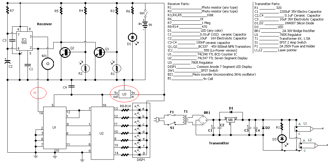

Could you please see if what I did is right or wrong ?
and do I have to add something where red question mark is
Look at the datasheet for a uA7805 regulator. They recommend using a 0.33uF input capacitor. Yours on the receiver has nothing.
Look at the datasheet for any old TTL IC. The absolute max input voltage allowed is 7V. Your circuit feeds it 9V.
Insted of using a voltage divider on the input to the old TTL IC then power the entire receiver circuit from the regulated 5V supply.

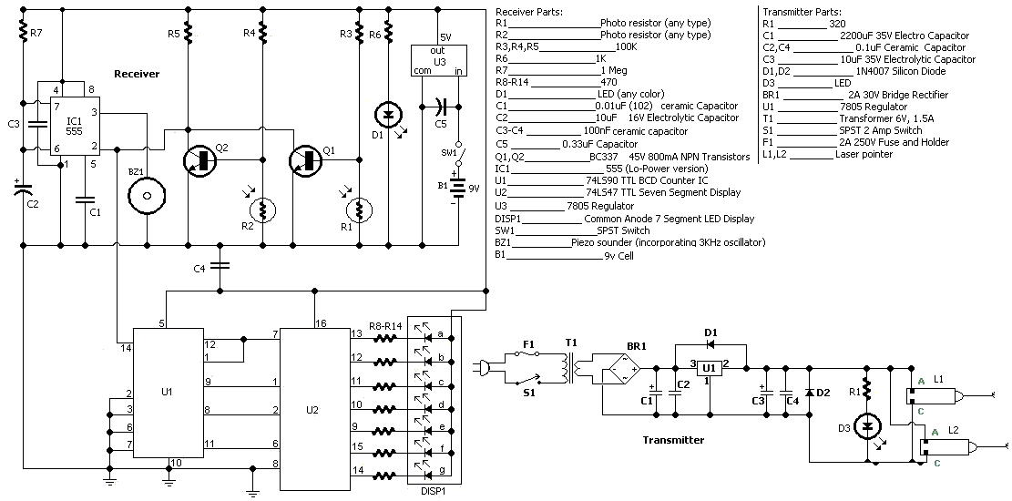

Hi again
please check this attachment
and C5 is electro or ceramic ? its not clear in the datasheet
A ceramic capacitor is a low impedance up to a very high frequency.
An electrolytic capacitor is wound around and around like an inductor at high frequencies.
Some film capacitors are also wound around and around like an inductor.
An inductor is a high impedance at high frequencies.
You want a low impedance at high frequencies at the input and output of a voltage regulator.
