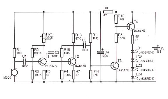

please help ... what is the wrong in this circuit?
A quick look, it should work.
Its supposed to flash the LED's when the microphone gets an audio signal.
We need more info from you..what is the wrong in this circuit? dosnt help
thank you Mr.ericgibbs , I connected the circuit but the LEDs are light in continuous shape .
Do these two quick tests.
1. Short the base of T3 to 0V, the LED's should off
2. Short the base of T4 to +9V, LED's should go off.
Let me know what you see.

hi ,
I have worked step 1 and 2 and the LEDs go off ,
Is the variable resistance RV1 and all transistors are true connected ?

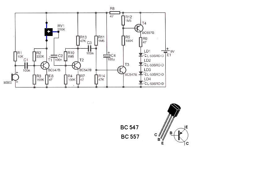

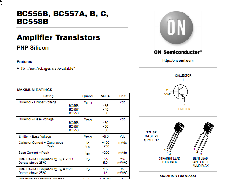

The last two tests suggest that T3 and T4 are not shorted.
The RV1 look OK
Look at these two images for the transistor pins, they agree with yours.
Disconnect C3 and check the LED's [then reconnect C3 after the test]
then
Disconnect C2 and check LED's

hi ,
thank you Mr. ericgibbs
I have worked these steps , but the trouble is still .
the resistors R10, R11 and R12 I used are 920 K ohms , is this true or they must be 1 M ohm?
hi ,
R10/11/12 are 1.5meg Ohms, using values lower than these could cause the problem you have.

The circuit is very sensitive. If it is built on a breadboard then the long connecting wires will pickup mains hum.
If the electret mic is not connected with shielded audio cable then its wires will pickup mains hum.
hello Mr.ericgibbs , I have replaced these resistors by 1.5 M ohms , but the trouble is still .
I removed the resistor R11=1M ohm , and when I touch some parts of the circuit like T1 or T2 or some parts , the circuit Works well .
