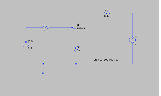

Asking for assistance, I need to place the VDS of JFET amplifier in the x-axis and the drain current ID of JFET in the y-axis.
Here's the pic of my circuit

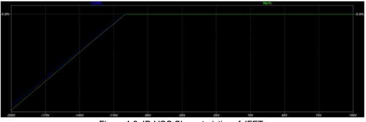

The simulation should turn out like this

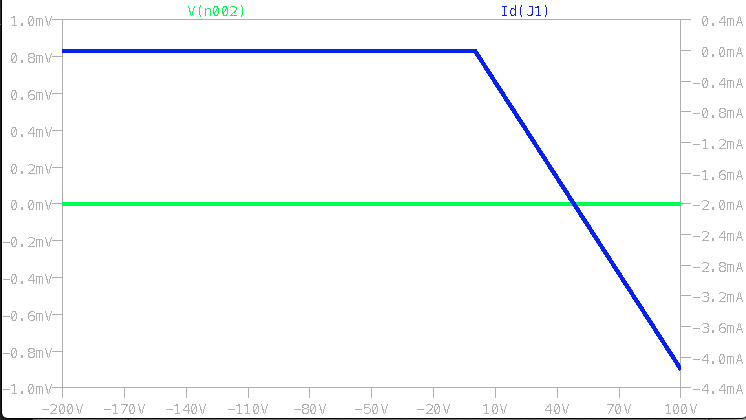

But every time I run the simulation, I got this

can anyone point out where I need to fix the problem?

Upload your .asc file for members to assist.
I think that you can click at function in graph and then edit equation.
Here is an example.
Files attached.
