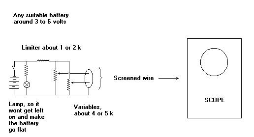

Hey there you are on the right track john1 . I have
tried it out by using two variable resistors connected
by movable joints. The output signals from the two
variable resistors represent the 2 co-ordinates. these
signals are to be sent to the cathode ray oscilloscope
in the e-lab so that a single dot is displayed on the
screen for the particular 2 co-ordinates (x&y). As i u
move around the map on paper its picture is retraced on
the screen.
The whole picture should be seen on the screen continously
as we see a pecture on the tv screen. So help me wiz the
signal proccessing techniques.
Still a few questions, but its getting there.
John

If its just a dot,
then things should be easy.
adjust at the scope end for gain and position
of both horizontal and vertical movement to fit.
Your suggestion of two pots to give the two signals
is of course the obvious choice, they come in log
and linear varieties, which is usually written on
the side with the value.
If you keep the values fairly low, and use screened
wire then the hum may not be too bad, it depends a
lot on the environment and the distance.
I cant help wondering if there is more to this than
i have realised, whats this about signal processing ?
I will include a small diagram of a possible layout.
This is just a suggestion,
i may have mis-understood this thread.
John

Hey john1 i tried to connect the outputs of the variable resistors to the cathode ray oscilloscope in the e-lab but i didnt get the trace out. Instead i was get two signals one fro horizontal & the other for the vertical sweep. This implies that there are more electronic circutory required in addition to wat u gave me.
I was of the view that if there is any body who can impliment a circuit which can display a character on the C R O screen, then we can buld on his idea.
Hi marronald,
turn the timebase off.
switch it to DC.
Horiz feed to ext X.
Vert feed to 'input'
From what you say,
this is what you need,
there is no more circuitry needed.
The scope has all you need.
Except possibly an amp on the X,
that might need stepping up a bit.
