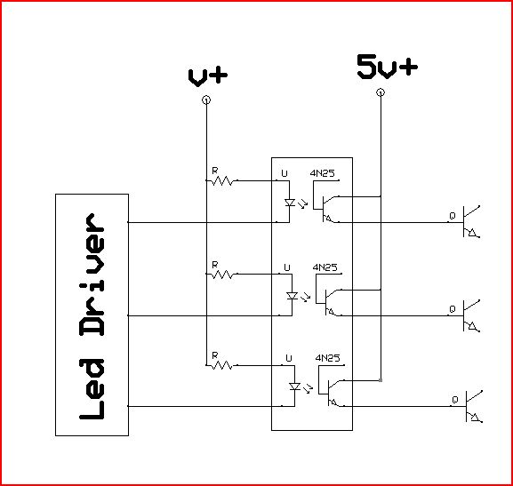

Here is a quick schematic that is not strickly correct as i just used the components i could find quickly to give the idea of where the resistors would go.

I will never fire more than 2 OPTOs at the same time. It will be a regulator. but one for every 64 Channels. So they can handle the load. Im running everything (Grinch, OPTOs, and Thyristor Gate all at 5VDC. I have NO idea at all of how to wire this thing up. So im not sure. :p This OPTO stuff is all new to me.
If your SCR is driving LEDs tied to +5 DC it will not turn off once it has turned on.
Why don't you drive the LEDs from the LED driver? Not enough current?

Ok if you are using 5 volt to the opto leds than 330 ohm would be as low as you can go but i would think 1K should be fine for the opto leds.

OTPOs in and I'm testing. They work great, but here is the deal... it wont open the Gate on the Thyristor. Ive tired 5 and 12V. I had to put a big 15omh resistor on the gate in order to make it turn off. It worked great when hooked to 1.5-5V but now even though im reading 5V at the gate through to OPTO.... It still wont open with the resistor there.....
Oh and also I put the 15ohm resistor on it because it kept firing on accident, by just me touching it, or hooking it up to the vga cable. I just tired it with a 1K resistor on the Gate, and it works great. But I know it will mess up as soon as I try to touch it.
So here is the deal, I can use a battery and open the Gate on the Thyristor, And I read 5V.
Now when I power the gate through to OPTO, even though I read 5V out, it drops to .10 at the gate? That make ZERO sense to me..... Is the OPTO not able to handle the Amps that is needs to over power the 15 OHM resistor on the gate? But that dont make any sense either....... hhhmmm
UPDATE: I didnt put the resistor to power the LED on the OPTO, and got 2.04V at the gate of the Thyristor. I gues there isnt enough Amps to open the gate. Any ideas?
